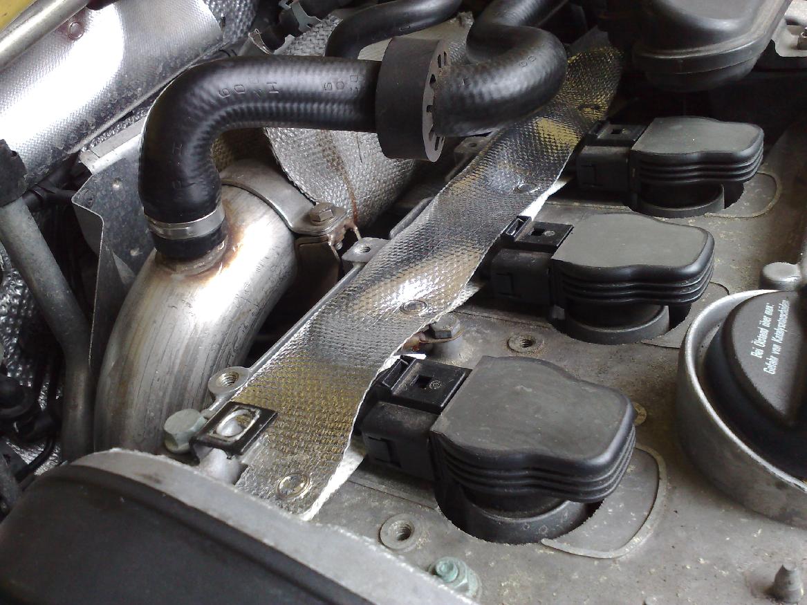

Here are some pics of it fitted:

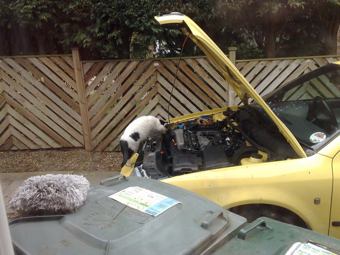

Went in for a brew (Changed brake pipes and ARB droplinks today :thumbup: ), looked out to find my new helper :rofl:
Didn't do a very good job though - Left pawprints on the manifold. Grrr!

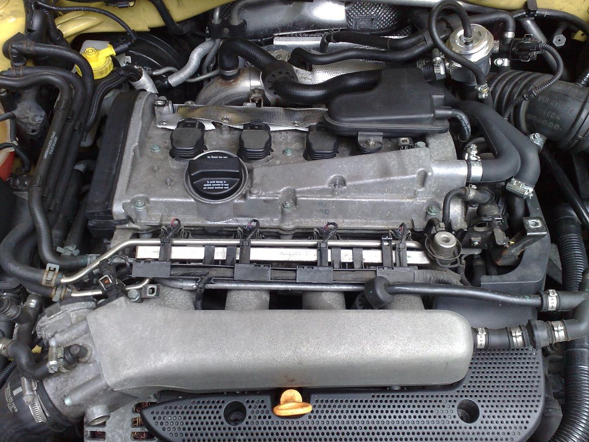

Is the one you fitted the same as the one on the link? They look slightly different.
Im guessing the initial wiring on the RHS of the engine feeds through the hole in the matting, right?
Thanks again Bowders.
Yeah, it's the same. Might look different because I trimmed the top left corner to go round the bracket which holds the engine cover and trimmed a bit out where the earth bolt for the coils is.
And yes, the wiring goes through the hole. :thumbup:
