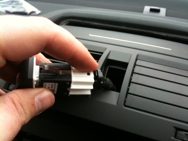

After removing the top box by levering the bottom / front edge of it, then you need to remove the hazard's cable connector by pushing the clip in.

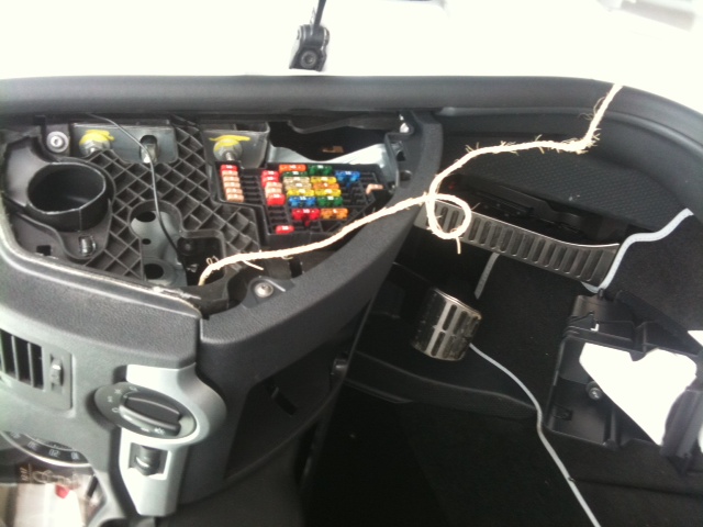

Using a bit of string to pull another wire through, in the fusebox end, over the drawer i mentioned, visible in this pic.

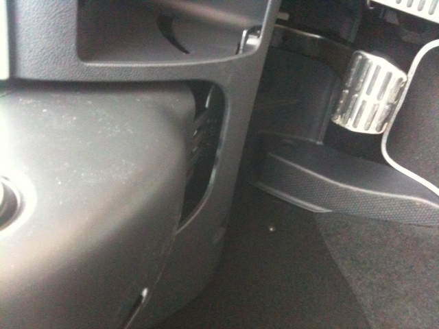

Under the steering wheel there's an empty bit of trim that acts as a tray for cables safely hidden out of view but easily accessed with your fingers to pull the cable through.

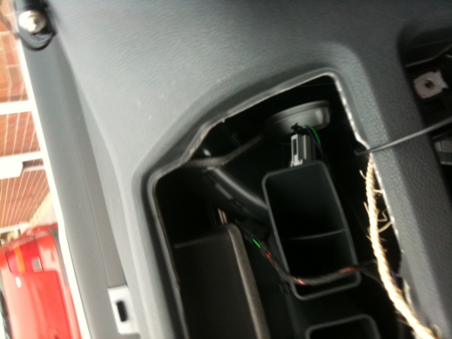

Reach down on the steering wheel side of the dash from the top box to retrieve the cable you've just run, in my case a bit of string.

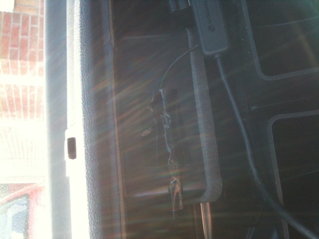

Taped the tomtom traffic aerial to under the dashboard, don't want any of it rattling under there.
