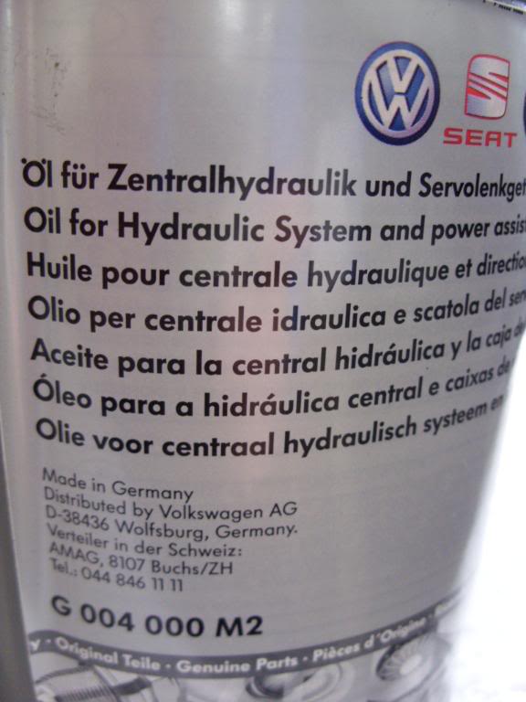

Have this on hand ready to use on my Fabia VRS for it's steering.
