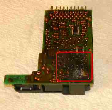

This is a very common fault. The part of the unit that controls the door lock burns out. Often, all the other functions keep working.

The driver's door lock doesn't work, but everything else controlled by the unit attached to the driver side window motor is OK.
We know in your case that the comms to the CCU are OK, the logic for the armrest switches are OK, the window is OK and I would guess the mirror motors/heater work too. Usually, it is only the part of the circuit that controls the door lock motor burns out. The control unit attached to the window motor is not available separately, so you to replace the motor. It must be the exact same part number.
Each window motor has its own controller attached and these are OK with the exception of the one in the driver's door.

Given that a new driver's window motor (which includes the attached control unit) is about £175, I suggest that you find a second hand unit. It must be a driver's window motor with the same part number, otherwise it won't talk to the CCU.
