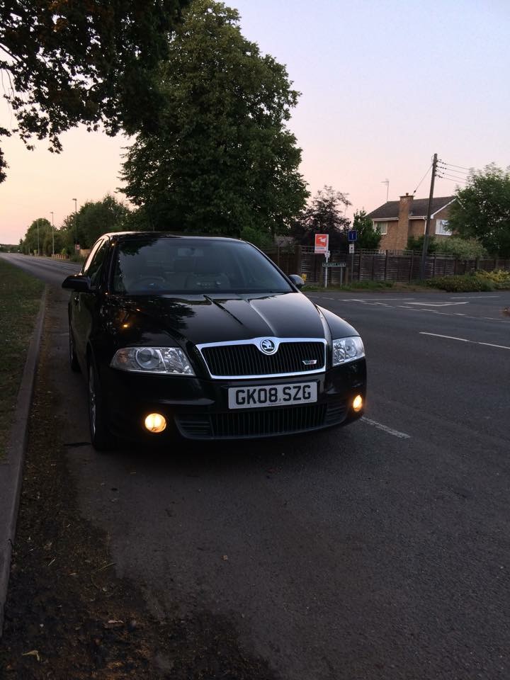

Here is my 2008 pre-FL Scout with it's front foglights set as DRL's at reduced output...

I left mine at 60% and having the wife follow me whilst I was driving another car they are still less bright than the non-LED DRL's on my Superb.
The pictures above show that they much less bright than full fog light power.
Had mine done last year at about 60% output I believe
Looks very OEM, much nicer than stick-on LED strips.
