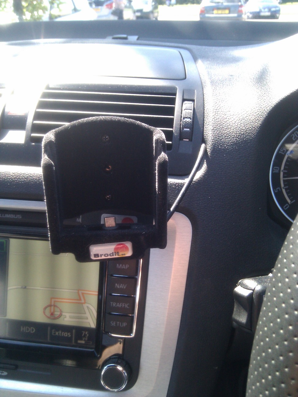

Would be excellent, much appreciated if you would bother taking a pic or two :thumbup:
Here you go, taken in the car park at Strensham services... I visit the best places emoticon-0102-bigsmile.gif
Hi, did you do the hardwiring yourself? I'm really interested in doing this in my new Octavia as well, to tidy things up a bit. Have you got a pic of your setup? Thanks in advance :)
Hard wiring is fairly easy.
Buy a cheap USB car charger, most come apart by un screwing the bit that goes into the ciggy socket.
I then soldered two wires to the circuit board inside.
The central connector is live.
Take out the fuse for the ciggy lighter.
Take out the cubbyhole below stereo by undoing the couple of screws. Unclip the gearstick surround.
You can now see the ciggy lighter wiring. Connect up the two wires using some kind of clip lock connector.
Remember the central wire is live.
Zip tie the newly attached charger to the rear air vent tube.
Using a long USB cable route it to where you will place it in the car. Mine is lower right of windscreen.
