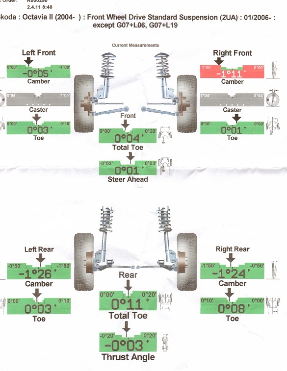

I suffer from a lot of road noise (expected from having bridgestones), after reading a lot on here I went to the local tyre center and had the geometry checked. They said everything is ok and didnt adjust anything. The printout they gave me shows that the front right is a bit out (and in the red) however they say its close enough.
Looking through other threads here, most are for sports suspension (mines just a little 1.6fsi with standard suspension) so didnt find a lot of info for non-sports suspension. Does this printout look ok, ie will it being out this much affect road noise?

That front right camber angle would concern me - it is a fair way out.

I don't think i'd be happy with that at all!

The garage gave you that print out as you've loaded, and left the car setup like that?!
They're supposed to aiming to have the values in the middle of the 'sweet spot' as shown by the arrows. The camber for the left and right wheels should also be broadly similar. Yours certainly isn't.....
thats strange as front camber is fixed on the Mk5 chassis, unless your model is different to the vRS. So the front should be on 10(thats the vRS value) negative camber and identical on both sides.

Front camber is adjustable to some extent - a case of slackening bits off and moving bits about then tightening back up again. Could be a subframe alignment issue as you have too much negative camber on one side, and not enough on the other. Has the subframe been out to your knowledge for a clutch or turbo replacement? Main dealers have a habit of dropping the whole front subframe for doing some jobs as it is quicker as long as you have all the right jigs etc.
How come your caster angle wasn't measured?????

That is only a 4 wheel alignment by the looks of it, not a full geometry check. Seeing as you are a fair way out to start with get it done properly.
