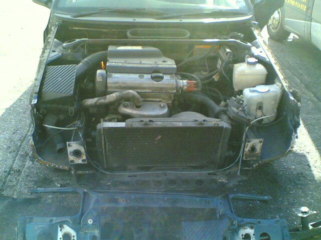

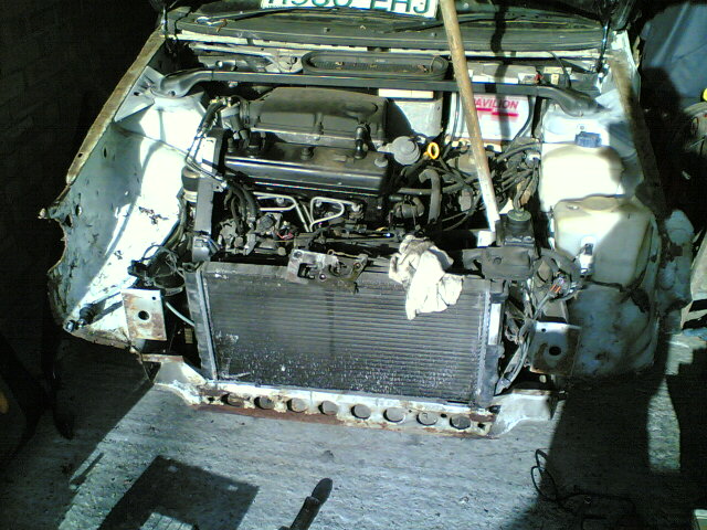

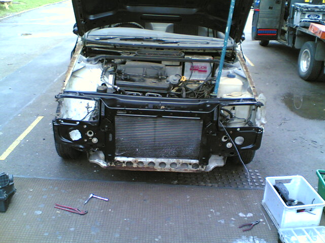

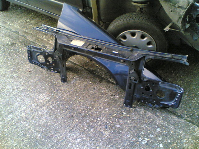

that's interesting stuff, you didn't by chance take a pic of where you drilled out the spot welds? mine is so rotten i can't even see where the welds are
post-68203-0-45922000-1303150029_thumb.jpgpost-68203-0-17368000-1303150047_thumb.jpgpost-68203-0-36894400-1303150067_thumb.jpgpost-68203-0-94941300-1303150148_thumb.jpg
these are the best photos with the front panel off,
i think it was only spot welded around lights/bumper mounts & bottom by rad,
easist front panel ive ever taken off & re used,
thanks for those rich, from the pics it looks like you used a proper spot weld drill...
i've never seen felicia with the front panel removed before, i never realised that the front crossmember was perforated like that at the front... when mine is off i don't think i'll bother welding it back on, i'll just bolt it on to make it quicker and easier to remove and refit the engine
