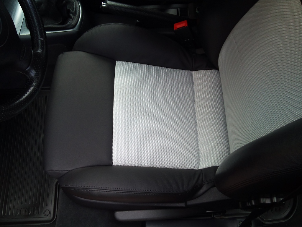

they are audi s3 seats, and they are a direct fit so no messing around with frames and are so much nicer than the other vag seats i have used for comfort. They come fully eletric with lumbar support and seat heating too :)

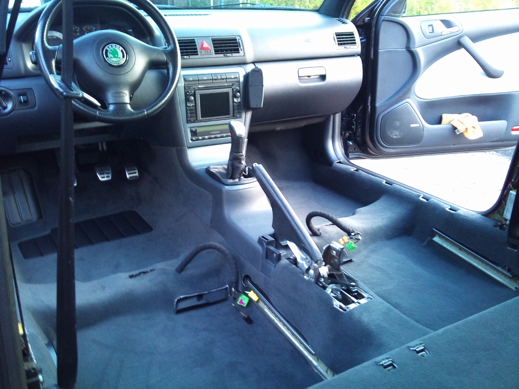

Recently changed my old carpet for a black one too. Got a brand new carpet from Germany for 340 Euros, and while I had the seats out I replaced the drivers seat foam and cover as well. Backbreaking work, but well worth it as it looks the business compared to the old setup.
