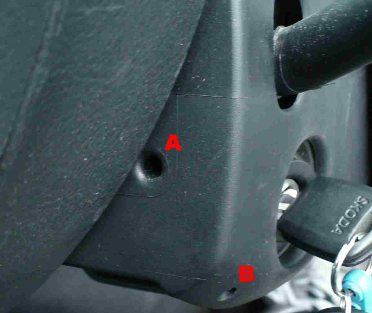

I couldn't find a 'how to' anywhere so I took a few pics to get you started. You don't need to remove the steering wheel itself.
Adjust the steering wheel to its lowest position and with a flat screwdriver, carefully prise down the clip that holds the flexible column shroud.
Turn the steering wheel to reveal both column shroud screws on the right (marked A and B in the pic). Turn the wheel again to reveal the left hand screws. You need a long Philips #1 screwdriver.
Pull the steering wheel fully towards you. Undo the two screws that secure the steering wheel reach/tilt lever (marked C). You need a Torx T25. Now undo the screw that secures the lower column shroud (marked D). You need a Hex 4mm for this one. Remove the shroud.

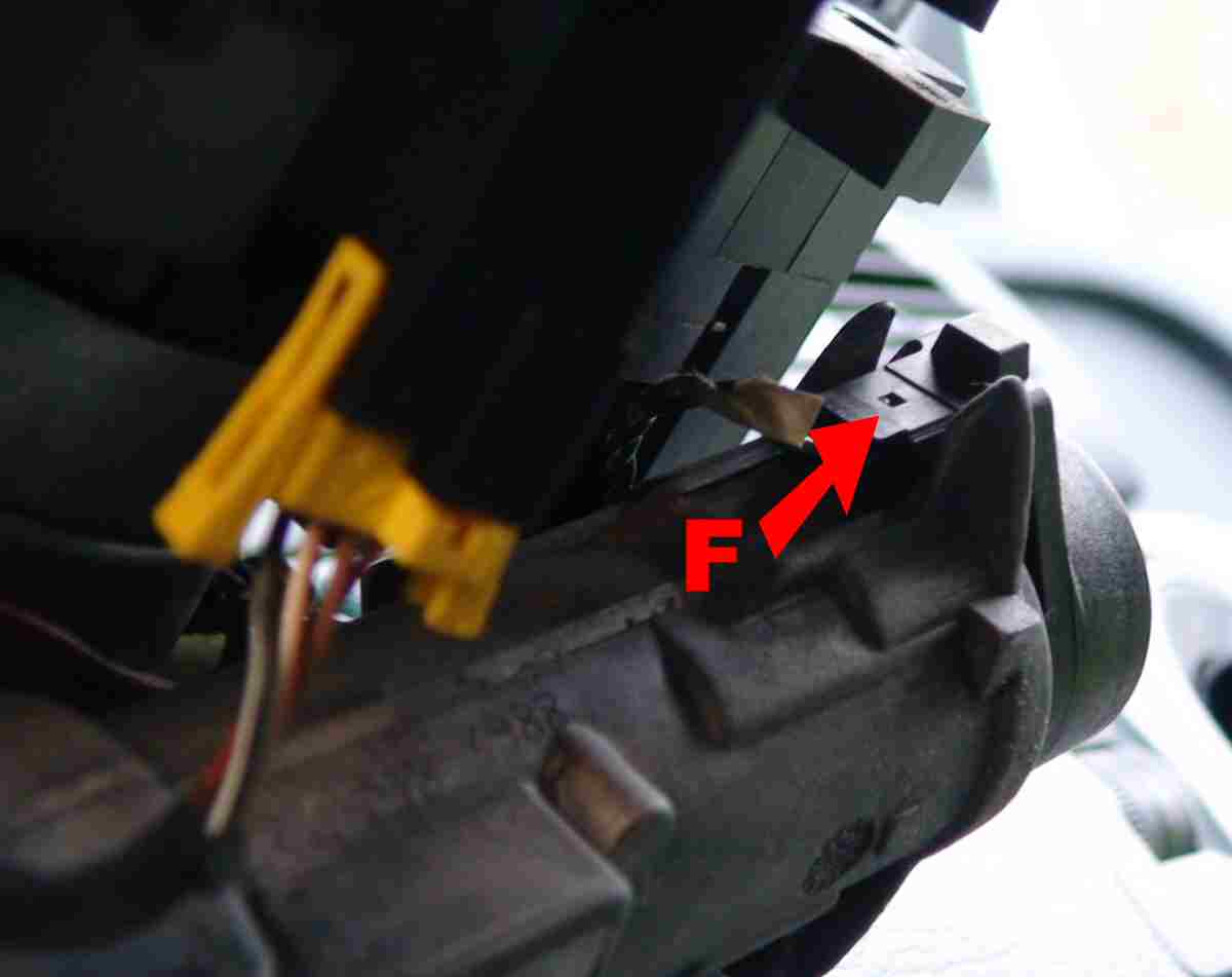

The following two pics show the loom (twisted pair, black and green, marked E) and the plug to the immo reader coil (marked F).
post-2559-0-25848500-1303239476_thumb.jpg post-2559-0-99695000-1303239462_thumb.jpg
From here it is just a matter of carefully following the loom back until you reach the plug on the other end, replacing the loom (don't untwist it) and reversing the process

Thanks for the pictures rwbaldwin. Been trying to get into mine, but my steering column like different to this. It is a 2000 Octavia. Do I need to undo the screws under the steering column? Any ideas anyone?
