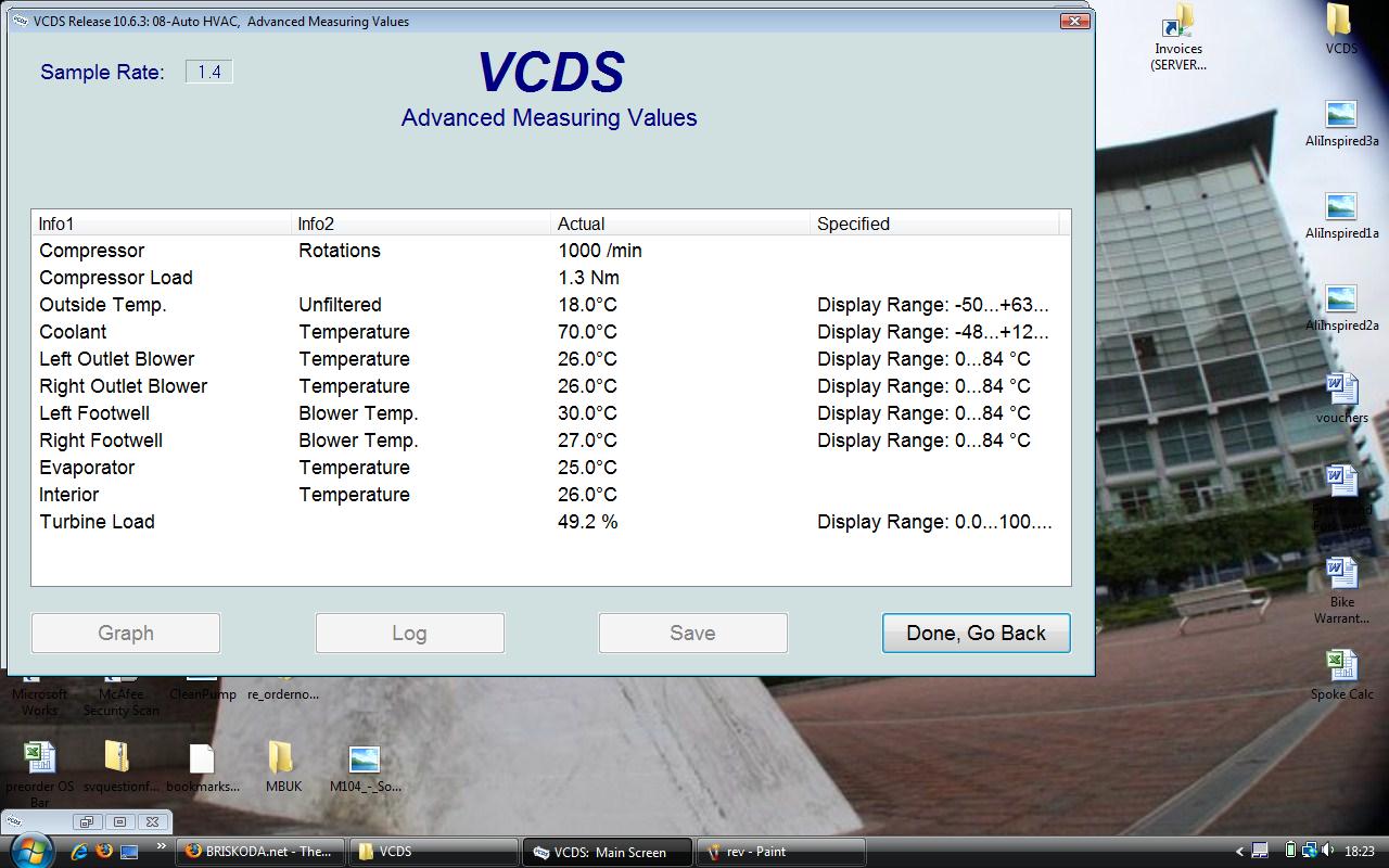

1. Car idling with AC turned off

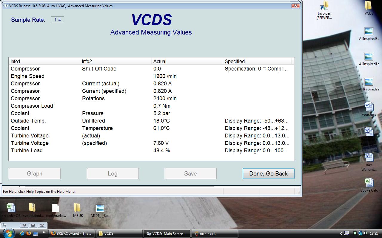

2. Car idling with AC turned on (I'm no car whizz but that looks normal?)
3. Increased the engine revs (again looks fine to me?)
4. And another one at idle with different outputs shown... this is with the system set at 5 out of 7 bars 'power' and 'LO', so it should be blowing cold I'd have thought!

The compressor still seems to work (it goes from 0 to 1000rpm when the climate control is turned on and a load is shown), but I can't get it to blow cold:

The compressor control is being instructed to operate at maximum displacement (current >= 0.8) but the load (should be > 4.5Nm) and pressure (should be 14-16 bar) are too low. The compressor or N280 (part of the compressor) seems to be faulty.
Hook up the system to a manifold gauge set or a/c station to confirm.
