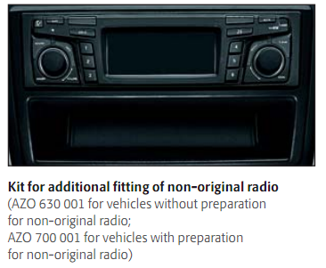

So I decided to put a nice after-market piece in place of the Blues that I have, but for some reason my dealer does not know (or is too lazy to find out) what parts are required.
Looking through catalogs I see:
1. kit for additional ï¬tting of non-original radio AZO630001 for vehicles without preparation for non-original radio; (this would be my case, I guess)
2. kit for additional ï¬tting of non-original radio AZO 700 001 for vehicles with preparation for non-original radio
3. kit for ï¬tting a non-original radio AZO 700 001 & AZO 700 001 A
Does anyone have experience in changing Blues to After-market?
Thank you!

My understanding is that you need a new radio surround (either 1 DIN or 2 DIN sized depending on your new radio) and a wiring harness to couple things together. You are likely to lose any visual displays on the new radio such as parking sensor outputs or external temperature readings (if these are present on your existing radio).

I do not think I would lose anything. I did not opt for parking sensors (worked as a valet in my student years, so I can park a Hummer blindfolded :), temperature is displayed on the little LCD screen that also shows MPG and other good stuff. I think I need the kit shown in the photo below... Or I could trade my Blues radio with someone who bought bare-bones Yeti without radio at all (as far as I know those are prepared for after market installation).
