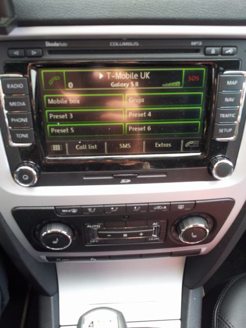

Just to let people know that the new Samsung Galaxy S2 works out of the box on rSap mode.

Got mine yesterday and it connects with my rSap only MkVI Golf. Hopefully it should also work on our Octavia Scout in rSap mode (which will hopefully be built in the next few weeks).

I have the S2 and it works well in my columbus (superb II 2009).

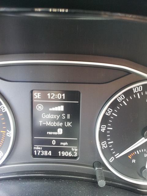

2- Your MFD has 3g, premium and bluetooth icons, mine has 3 "_" lines. (have 2764 firmware on columbus do I have to update firmware on MFD.

2. I think mine is on 2764 too, it's stock one from April 2010 when the car arrived, I have never updated it.

2 - Cant see why I dont have the 3G, premium and bluetooth icons. Anyone ???

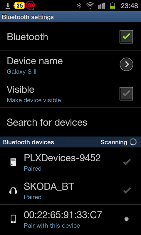

I've found a procedural solution now.
1. Disable Bluetooth on S2 (or switch flight mode on) before switching on ignition
2. Switch on ignition
3. Enable Bluetooth (or turn flight mode off)
4. Car connects with RSAP connectivity and mobile network
Well, it works for me every time, but it's a bit of an annoyance.

Also there is no need to turn to Airplane Mode. Just make sure you turn the BT after ignition or after you start the car. Never fails to work properly and always connects if out/in the car again.
