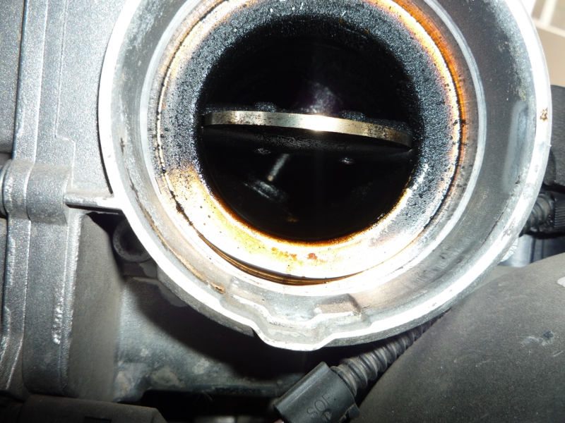

This is mine before 1 000km:
And the valve before it:
Regards
