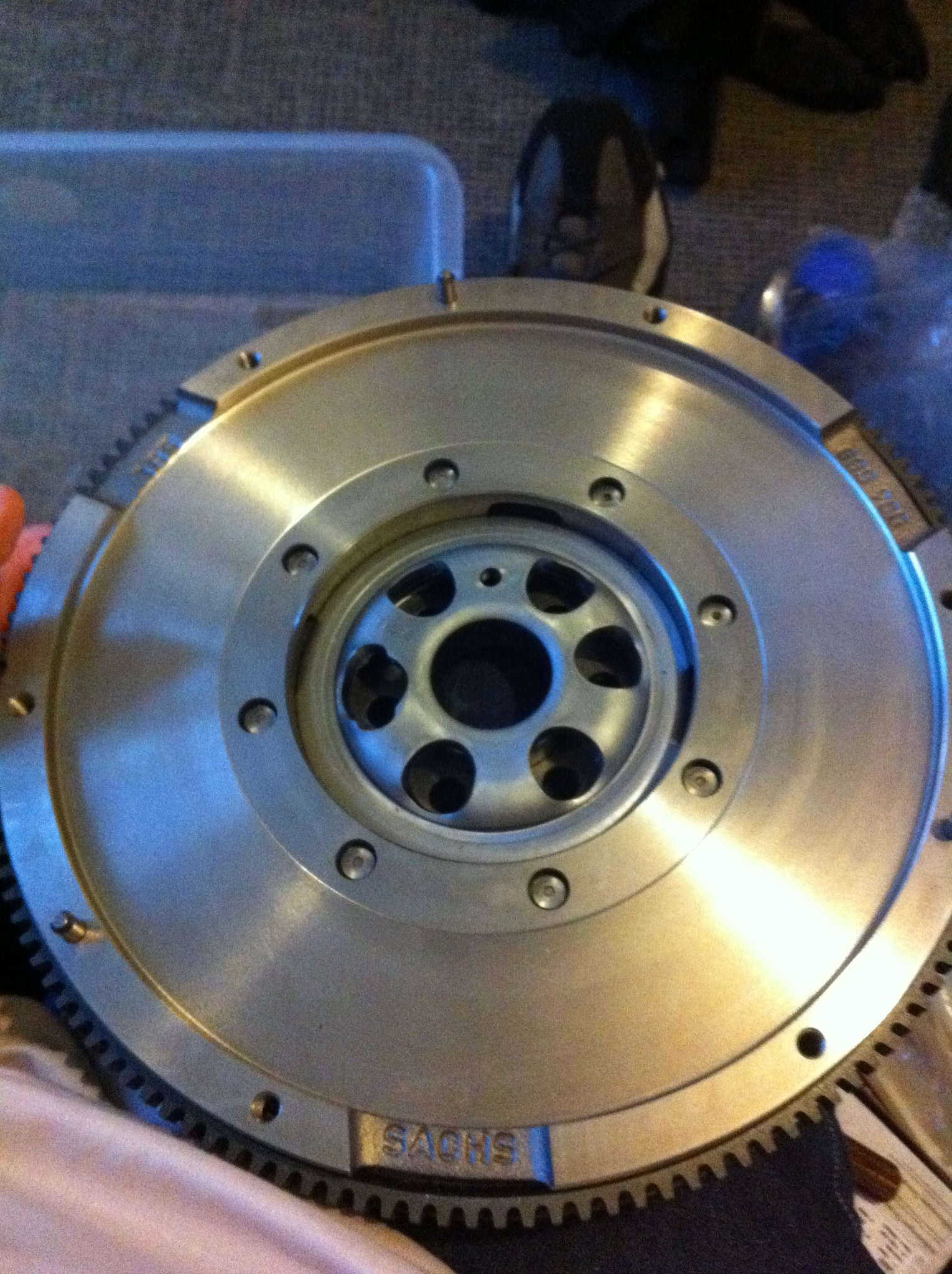

One thing i wasnt expecting is how bloody heavy the Dual Mass is my god there is some weight in that must be well over 20kg.

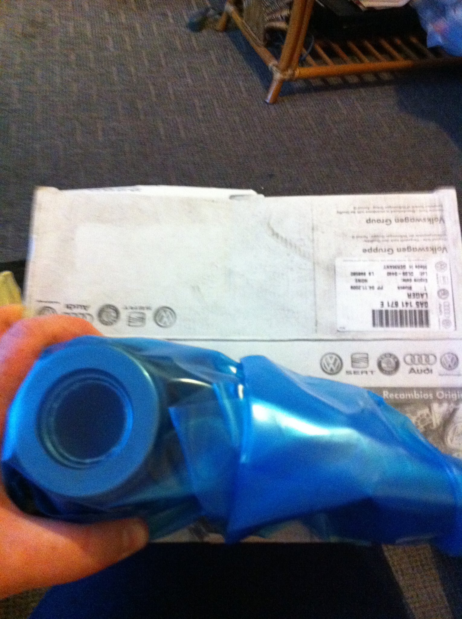

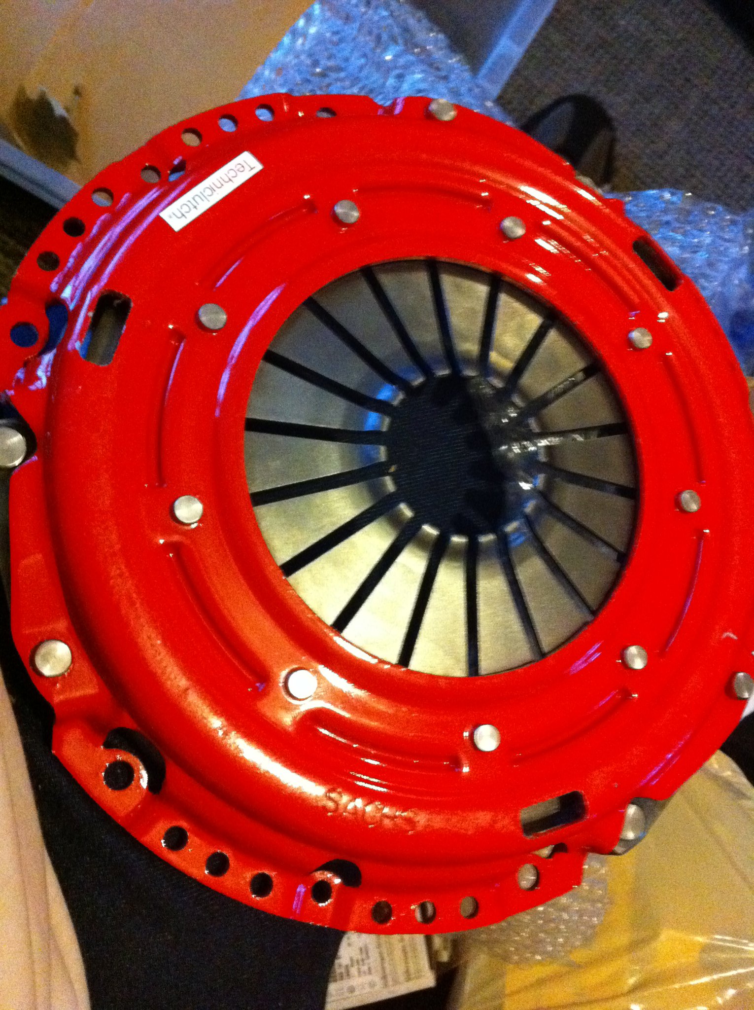

a few pics of the kit
and the rest plus there is all the bolts ect for fitting

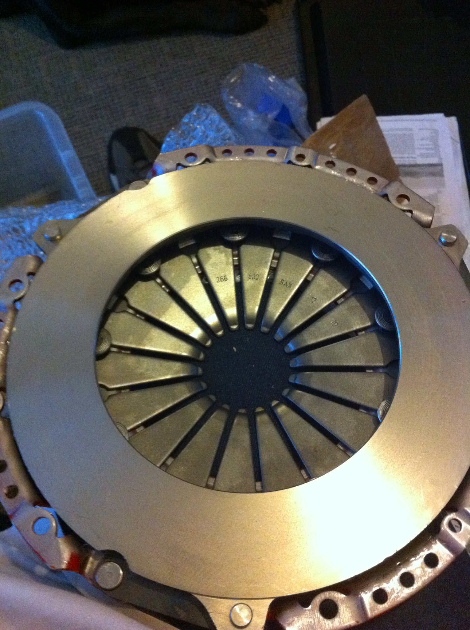

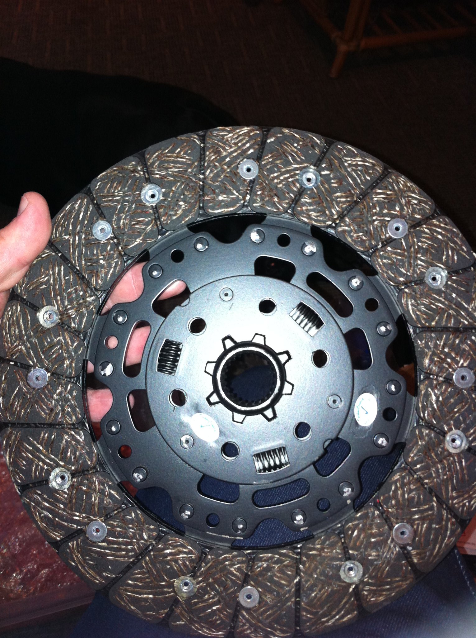

A sach uprated one for comparison
looks a very similar design i know it wont be as strong but my funds would not stretch another £700 on top of what i have paid if it can cope with the 302 ft-lb i have now i will be very happy when its time to upgrade the turbo i will look at doing a sachs fast road clutch if needed then but the dual mass hasnt been changed for 165k so that needed doing anyway.

From the pics, I still don't understand what you think is "uprated" about it. That's clearly a standard clutch cover (you can see through the red paint it's only marked SACHS, not SACHS RACE ENGINEERING), and the same with the friction plate which is a different design from the race one.
IMO, it looks like what I've read about Techniclutch is possibly true, and they really do just sell reconditioned and/or painted OEM parts.

has anyone got a pic of a std one? that comes in the fabia
OEM Sachs item.

My mate who is helping me owns his own tuneing company he specialises in tuneing Focus ST/RS to high levels he looked over the clutch and in his own words "This is a nice bit of kit" I asked him if there was any chance it was just a refurbed one and he said not a chance.

As Jase says though, more details from them would be nice. Or maybe what made your mate so sure it wasn't just refurbed? I still don't really see what there is to "uprate" as you buy the kit with only two parts. Only thing I can really think of is that they remove the Sachs friction material and put their own on, cos that cover looks the same as OEM to me (apart from being red), and the design of the friction plate itself looks the same as OEM to me (i.e. it's more "voided" than the uprated plate someone posted a picture of above).
