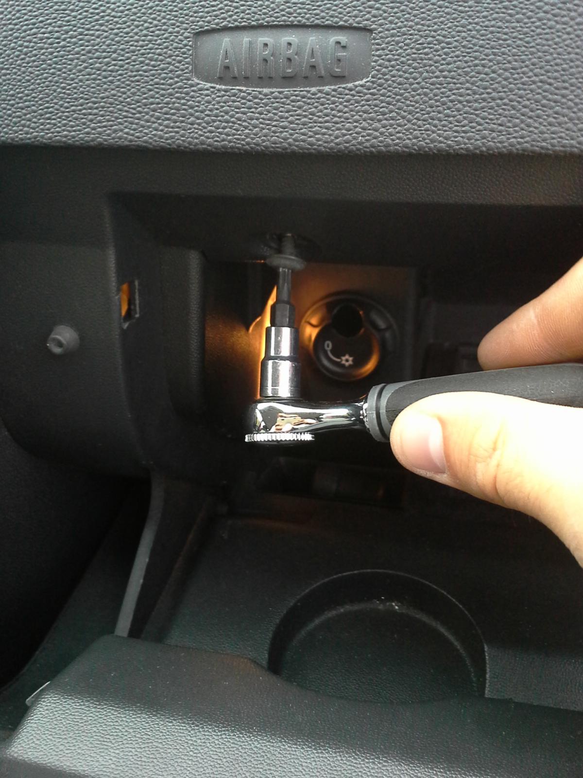

So, I'm figuring out how to install a active subwoofer (with built-in amp) under passenger seat on my Fabia Comfort Combi anno 2003. I've read lots about the glove box, so I decided to give it a go. My first problem was that three out of the five Torx screws that holds the glovebox is in a kind of narrow area, where it's hard to get a full-length driver in there. I then remembered that I have a piece of small sockets. I put a 6½ mm socket on a 1/4" ratchet on which the T20 bit fitted very well. Problem number one solved.

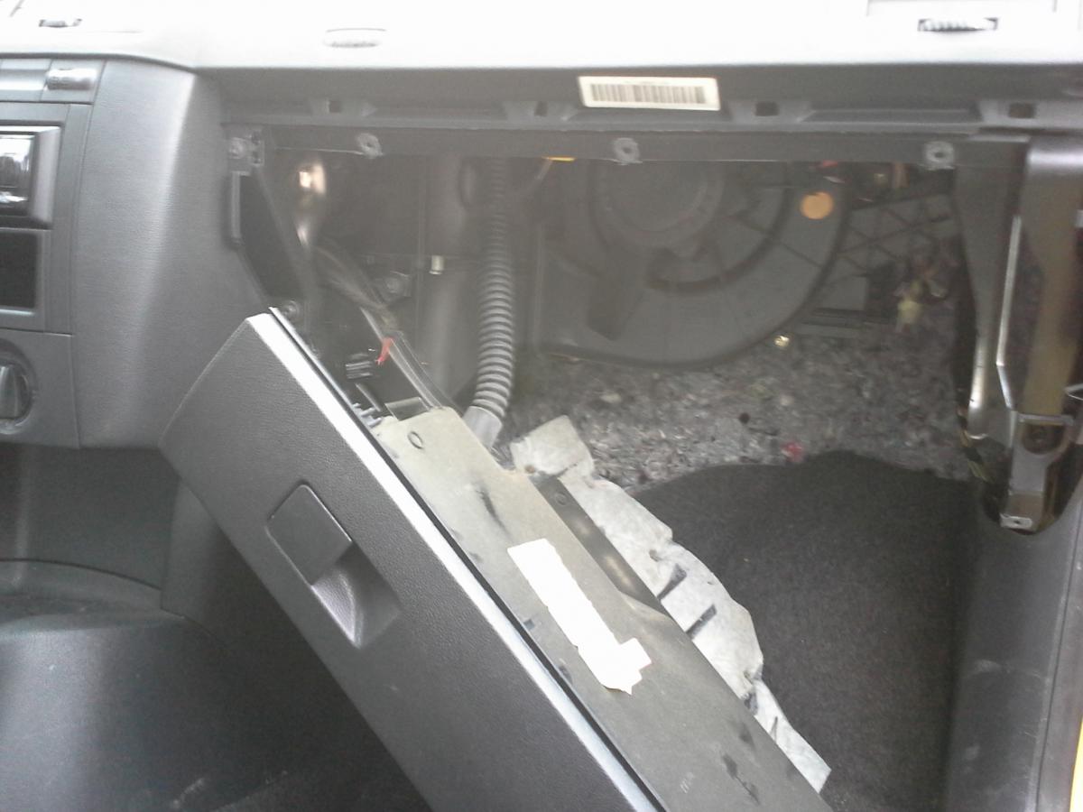

Anyways. The glove compartment came down and to be honest at first I was a bit scared that I would get problems putting it back in there. Also, I got worried that I would somehow short circuit the airbag controller so that a full blast airbag would blow into my head while sitting there, inspecting the behind. Anyways, I somehow managed to keep my calm.

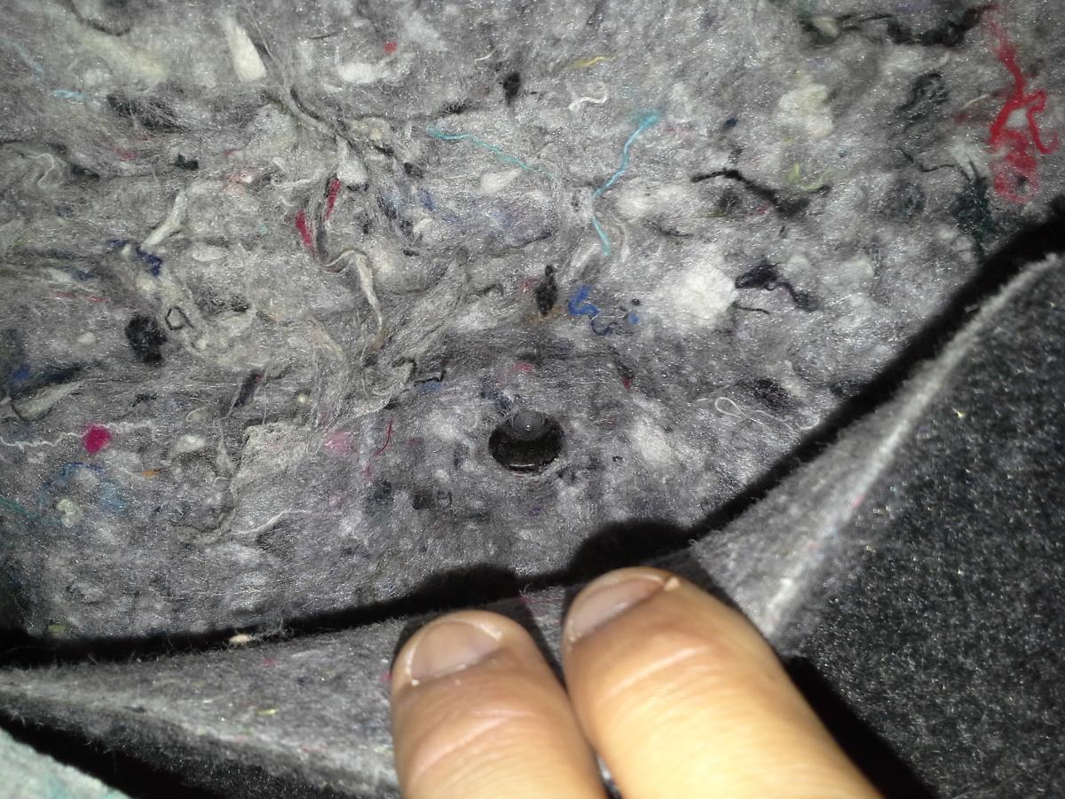

However, I couldn't find some cable-ready hole. The nearest I could get was a piece of the "mud carpet" where there was a hole, and it looked like a screw was sitting there from, screwed in from the engine compartment side. I could just see it's sharp bottom, plus some rubber padding thing around it. Is this what everyone's talking about? Am I supposed to unscrew this from the engine bay side, and then pull cables through the hole? In that case I should better go my nearest DIY garage where there's a lift, becuase this hole was so deep down so that I could never ever possible reach the screw from the upper side of the boot.
Thanks in advance for all input on this.
