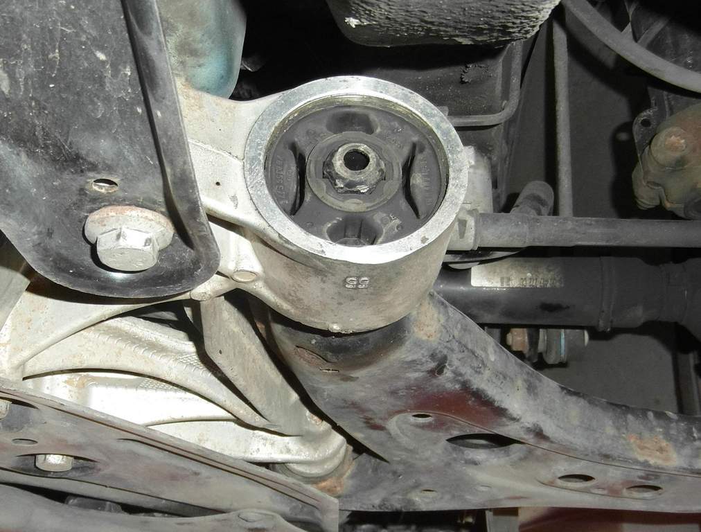

Thanks for the replies, so is this picture correct then?
Thanks Andy
Yes the thick rubber buffer goes on the inside.

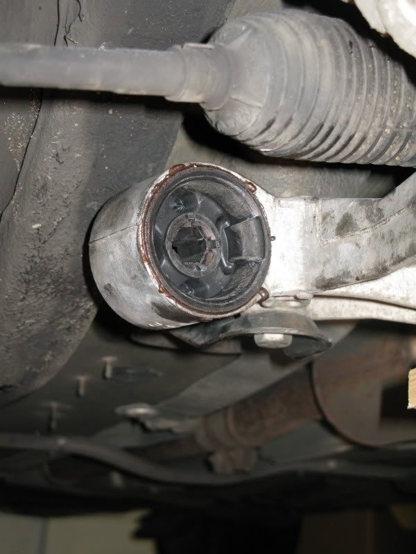

At last I've had the chance to get under the car, could someone clarify that these are correctly fitted please? I'm thinking they may be 90 degrees out.
Ta Andy
Need to see the other side of the bush to be sure.
Ok thanks I'll try to get under the car tonight to take a look.
