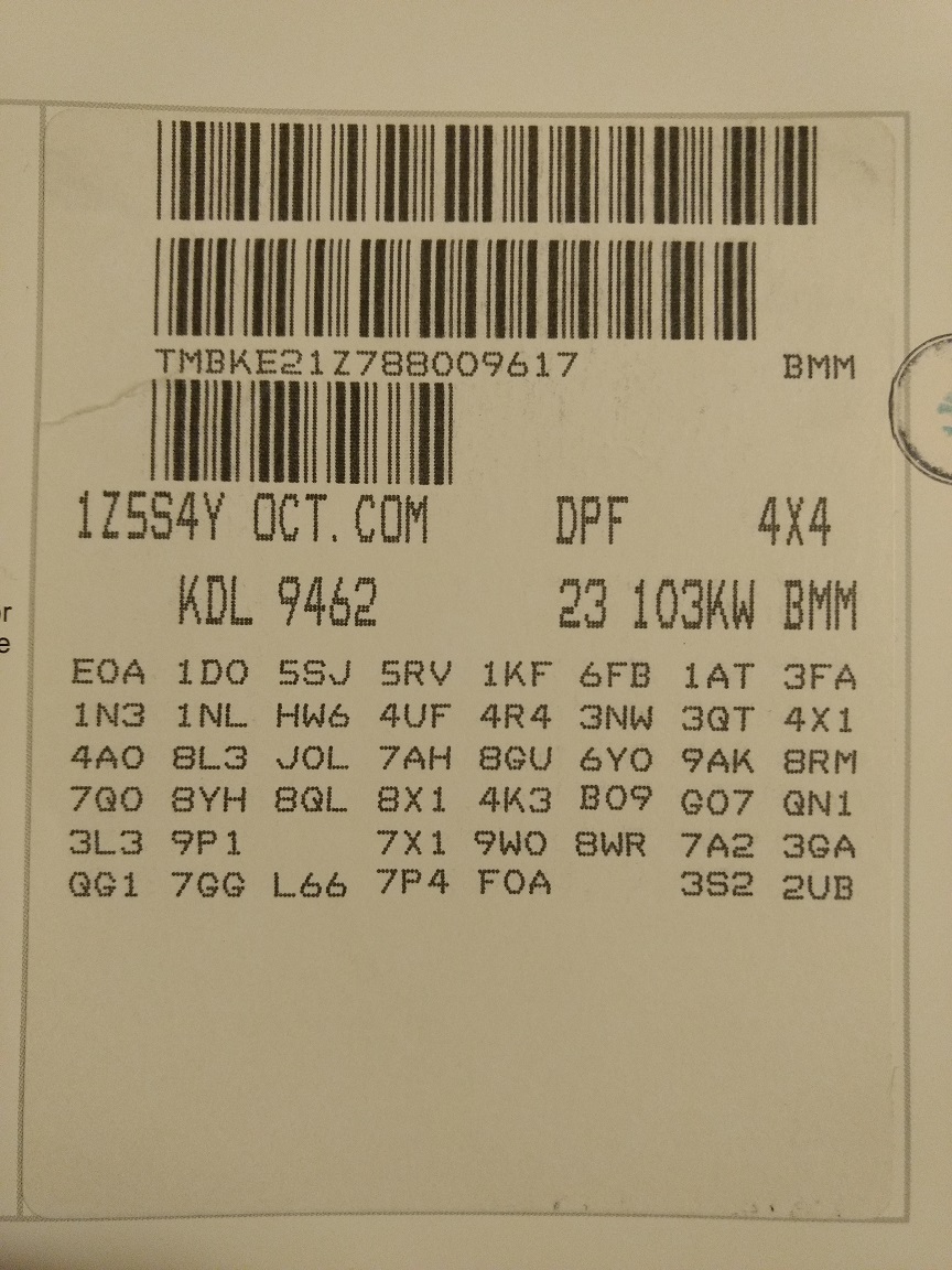

On 23/11/2017 at 10:03, 0ctavist said:
the official Skoda wheel combinations with(ja) or without(nein) snow chain(Schneeketten zulässig) permission( if snow chains not more than 15mm)
Look for your engine code, than the type, and compare your  e xxxx-  numbers
I've got the engine code (BMM) but I don't know where to find the type and the e xxxx numbers.  Can you help please?  Here's my data sticker (it's a 2007 Scout).
