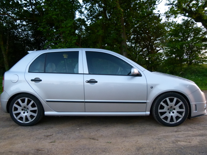

This is 20mm on the rear and 15mm on the front:
I found 20mm slightly too much with 205/40 T1-R's on 17" Spiders. I'm lowered as low as you can go on Weitec GT coilovers with no adjuster cups. I'd say 15-18mm on the rear would sit perfectly.
