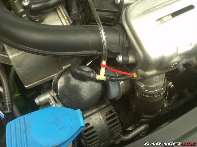

I know you could use just the one but thought it might be a bit different. Any chance of a pic of where you would take your feed from??

Depends on if you want the negative pressure aswell...
I am a lazy man, so I figured that I could fit it here :
This way, you'll only get the positive pressure :
Hope this helps!

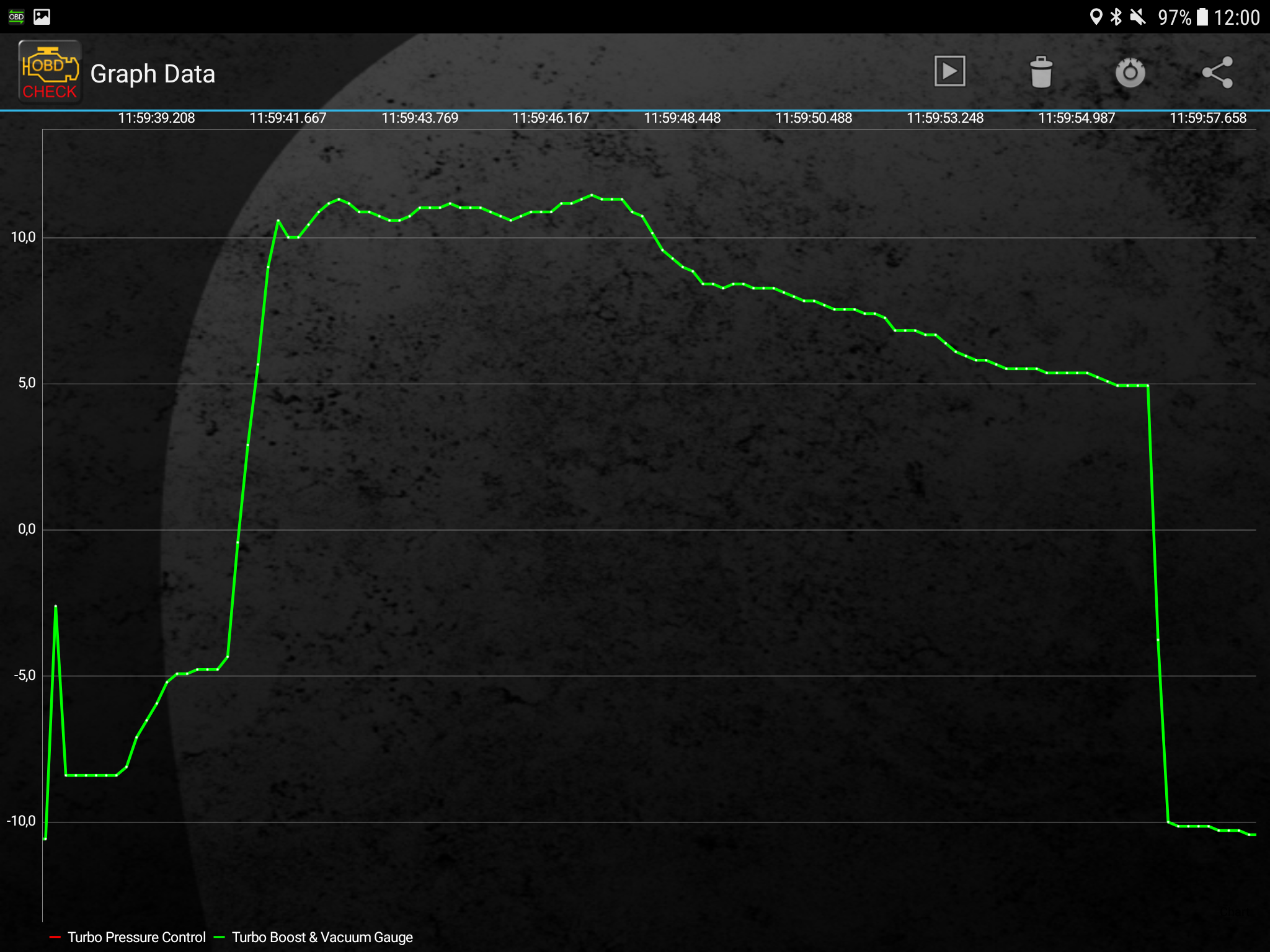

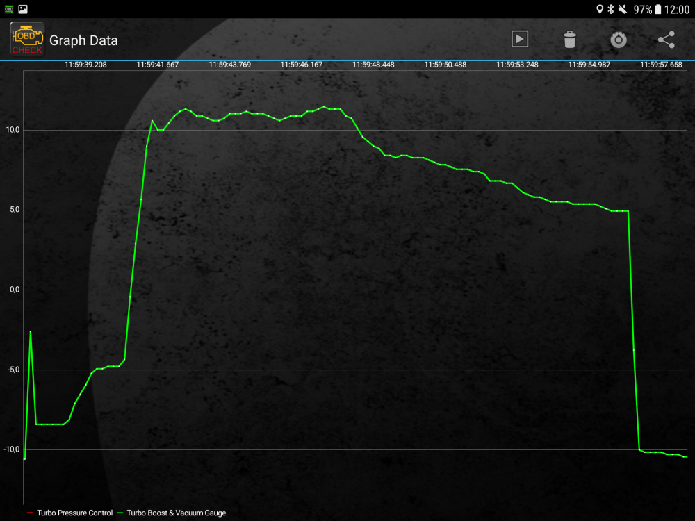

Hi,
This boost pressure chart is made with a 1.2TSI (CJZ) 110Ps engine. 2000 and 6500 RPM. Began in 2000 at the 3-speed acceleration. At 5000 rpm, the car is getting worse than the turbocharger and the boost pressure drops roughly to half. This, in my opinion, is not entirely normal.  The units of measure PSI. Can anyone help me with that?
