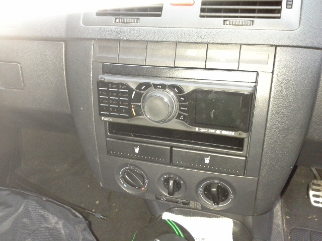

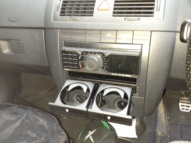

Hi thanks for this post I have fitted these and they do the job very well.
post-98139-0-48153400-1358550945_thumb.jpg closed
post-98139-0-21264700-1358550957_thumb.jpg open

I did order this through VW for 36.80 but worth it in my view.
Thanks again for the topic
