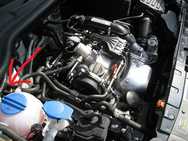

Hi, i solved >>>>>
occurs if the solution for 1.2 Tsi is too for the 1.8 Tsi
( as Polo & Golf 1.2 Tsi )

I did have the instrument cluster creak but that went away after giving it a few shoves (Had exactly the same problem on my previous fabia and two octavias!). This rattle is one of those ones where to easily replicate you put it in a low gear and floor it. Checked under the bonnet, cant see anything loose. Tapped various things but no joy so far. Wonder if its wires or something behind the dash tapping the bulkhead.
Is it easy to see behind the dash? I removed the side panel but its not easy to see anything.
GiscoYeti - Cheers for the photo, I'll have a look. Although on mine it sounds like its the passenger side.

Hi, i solved >>>>>
Thanks
I seem to have the same problem, vibrations around 2300 RPM. I have some problem locating the tubes on the photo though. In what part of the engine bay are they?
Thanks for any help!
I think its here, but its 3 years since I had a 1.2 and the memory fades with age  :giggle:
Thank you Wakey,
I'll have a look this weekend.
