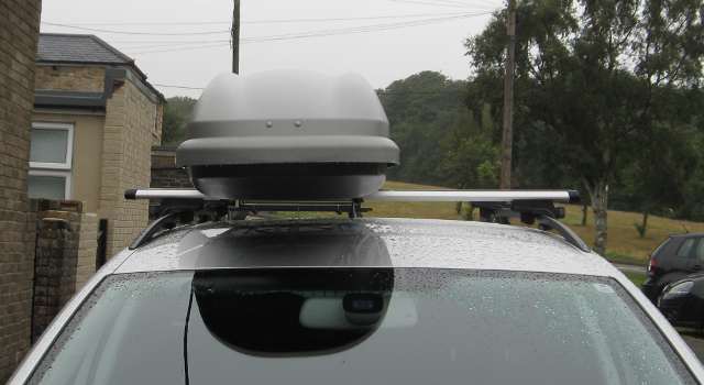

Thule Atlantis:
Excellent box, had snowboards and all sorts of holiday stuff in there, aero shape and easy to fit/ remove.
:thumbup:

+1 for the Thule Atlantis - I fit mine a bit further back than Rob. My old set up with steel bars is shown @
http://briskoda.net/forums/topic/101012-combi-roofbox-solution/page__p__1258173__hl__combi+roofbox+solution__fromsearch__1#entry1258173
I've got some aero bars now, but your Whispbars look the business. You answered my question about the powerclamps - I have a feeling they would foul the roof too, because the Whispbars are so low.
Also I note the length of bar you can clamp too is quite short, which prevents getting a bike on too, which I do on hols.
Great pics though - your Scout looks the business.
Here's my current car and roofbox set up - very happy with it. Its an Thule Atlantis 200 and Atera aerobars and cycle carrier. I note Thule do a more streamlined 'Dynamic' range now, which might suit you if you just want to carry skis and other odds and sods.
No extra noise and the car did 47+mpg fully loaded, with two weeks camping kit, two kids and two adults.

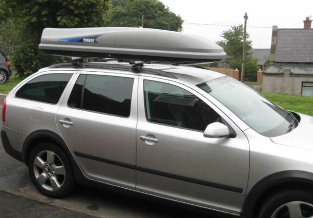

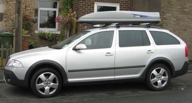

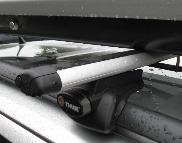

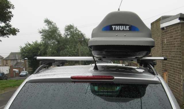

My roofbox predates my Scout so wasn't bought to fit so to speak. It's a tad over 2 meters long & is the Thule Evolution 500. I've seen what looks to be the same model in a more modern finish so think it's basically still available.
Coincidently I just put it on last night for a trip so I've taken some pics. It swallows most ski's (except for my old 210cm XC-ski's but I'm going shorter this winter hopefully so problem solved!)
It's currently loaded with a big tent, sleeping bags & mats for 3 plus plenty other sundry items. As the dog cage takes up half the boot & the lad's in the back seat it saves the car being rammed to the rafters with gear.

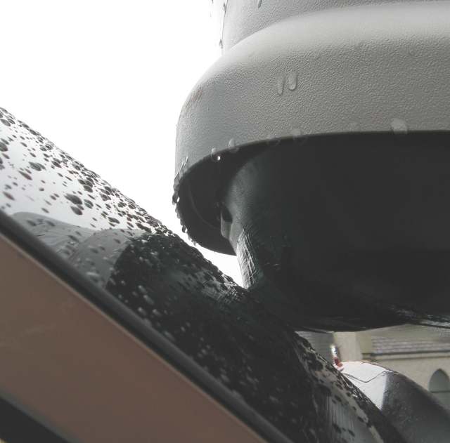

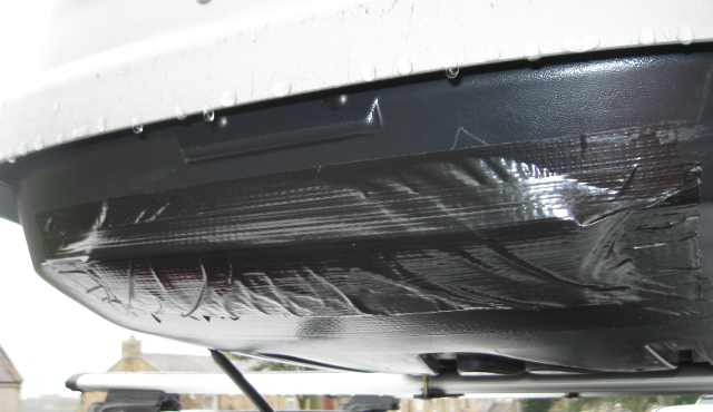

It's on Thule aero-bars. I haven't noticed any extra noise but do get a dip of around 3-4mpg from memory. Even with the box at the furthest forward position possible the boot hatch touches the box when open & the first time left a small scratch on the glass. I chucked a rag between after that but last night cut some closed-cell foam & duct-taped it on the contact point on the box.

Another with the Atlantis 200, although I bought it for the old Outback rather than the Scout, and have only done a run across the suburb with the scout. Thule bars too - sorry no pics.
... It's a tad over 2 meters long & is the Thule Evolution 500. I've seen what looks to be the same model in a more modern finish so think it's basically still available.
Even with the box at the furthest forward position possible the boot hatch touches the box when open & the first time left a small scratch on the glass. I chucked a rag between after that but last night cut some closed-cell foam & duct-taped it on the contact point on the box ...
