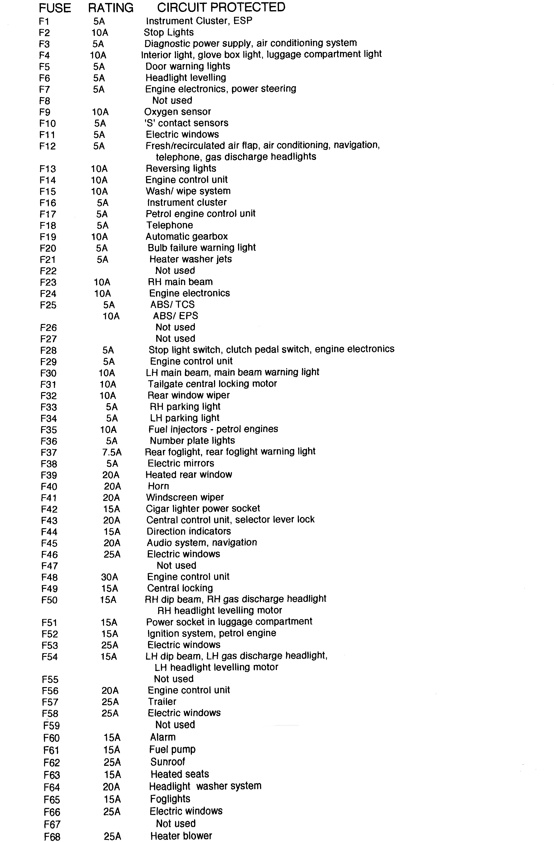

You've missed 46 and 58 and the fact that the problem sometimes has nothing to do with the fuse you think it might relate to. If both mirrors and windows aren't working it might be something else - but don't ask me what! (Could be failed connectors/broken wires)

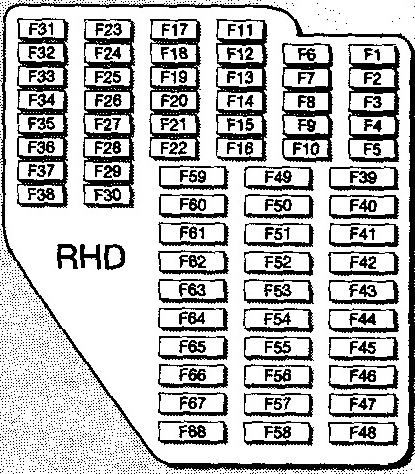

See attached lists from 'Haynes' manual.
