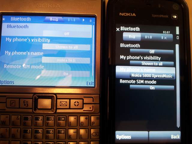

Here's a picture of 2 Nokia's Xpress5800 and old E61i, (both tested on my Skoda worked fine) they both have rSAP. Check Bluetooth settings.
Also check within the Phone menu for Phone Management->Device Update" as newer Nokia phones can update over the wifi without you loosing anything.
Dial *#0000# and check what version are you running, latest is v71.004 for E72.
I doubt 3 would customize the Nokia. E72 is pretty new to be missing rSAP, and if it really is customized then, get Nokia PC Suite (a good Phone management/backup app), backup your phone, then download Nokia Software Update(should be an option within PC Suite, and see if a new firmware is available for E72, and de-brand your self from 3 :)
