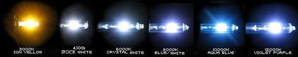

- The D2S bulbs are right, however do buy bulbs with a well known good brand. There is a lot of bad quality out there. Same goes for the other items. The number is the color temperature. 4300K is the original bulb temperature. Higher means more blue and lower means more yellow.
- Forget these ballasts. They are for aftermarket and does not fit without modifications. Go for the original ones. So wait and see if it can be solved by a new pair of bulbs first.
