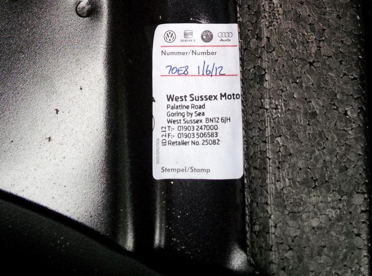

If you're unsure whether the update has been done, look for a sticker on the boot floor, under the carpet, like this:
If you have one, the dealer is saying they've done the update.  I guess the only way to be totally sure would be to check with VCDS?
My electric seats have never moved on their own since I got the car in July '12 (after the update, judging by the sticker date).
Hope that helps someone.
