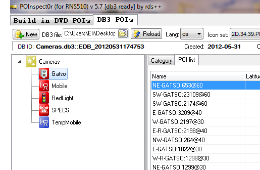

<p>To the people with problem of the "greyed out button",I had the same problem, and here is the solution:
The problem lyes in the way you built the file directory.
In the "root" of the SD card, create a folder named "PersonalPOI" and in that folder you should put in the POI database.
Also in order for the database to load correctly, when you compile the file in the "POI Inspector" program, you should save the actual POI's as a "sub category" as a "child" to a main category. Here is a screenshot of my file structure that worked perfect on my Superb:
I hope this was helpful!
Liebel
