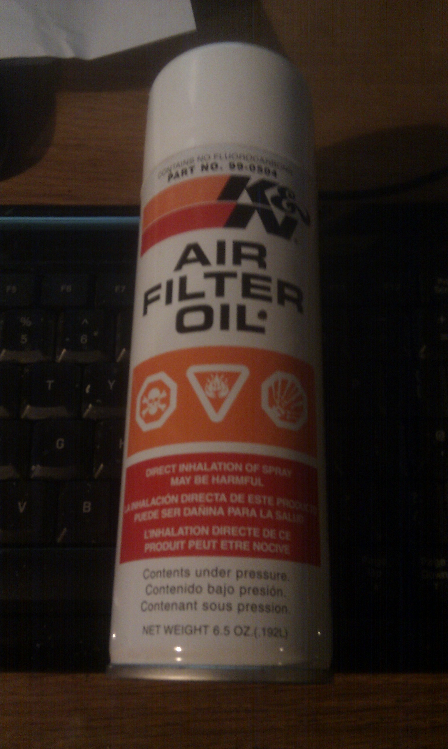

Pedant warning.
It isn't engine oil you use on K & N filters, but a special light oil.
Pedant warning.
When I clean the filter and re oil it I always dab the whole filter and surrounding plastic with kitchen towel ...just to make sure, and then leave it for a few hours to soak into the cotton itself ....not had one single problem with six filters in six different cars.
the way I look at the filter is less resistence is good, more air in, more fuel in, bigger bangs, more power .... and the good thing is it lets more air in for far longer than the standard filter before it needs cleaning...and it will be a an awful long time before it needs changing saving money on that in the long rung run as well
Here is the oil....just ordered another cleaning kit as I am running low....but in fairness it has looked after at least one clean on six different filters
