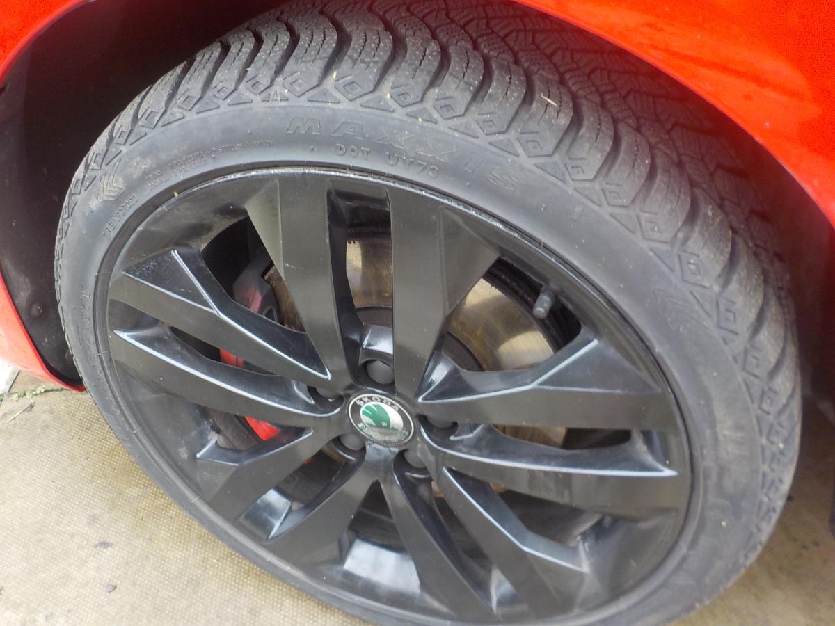

I have plenty of pairs of tyres on wheels for Fun Days, & Maxxis AP2's for Snowy / Icy Wet fun days.
I carry 2 Spares that match for trips so not caught out when Directional Tyres are on a car i am using.
Tigar are 205/40 R 17 £52 fitted.
Maxxis AP2 are 215/40 R 17, sidewalls not strong, very good in Cold, Snow, Wet etc, pretty good in the warm actually. Much Cheapness.
