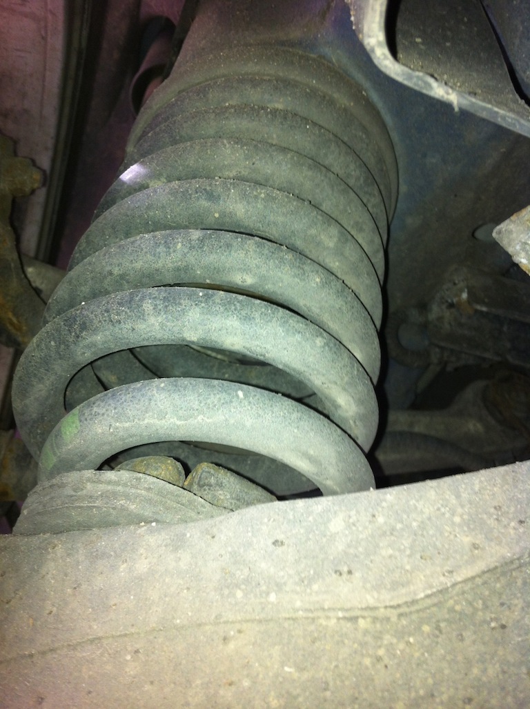

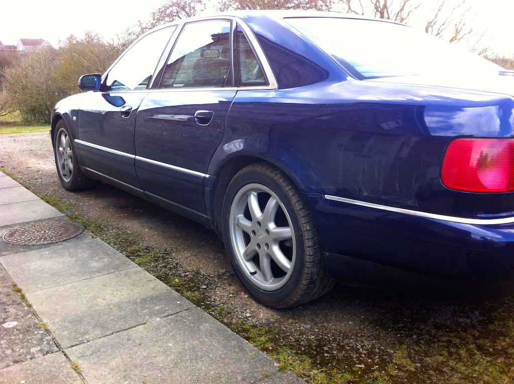

This weeks problem, Rear coil springs.
Filled the car up with Petrol for a run up to Hertfordshire in the week, and noticed that the OS side tyre was more in the arch than the passenger side even though I have nothing in the boot. After 175K miles it looks like the coil spring has possible broken at the end, well I think it has. See the attached pictures snapped on my iphone with wheels in place.
Another update,
Rear springs now replaced, and the car is once again sitting level at the rear. Also sorted the rusted screws on the ECU cover, so this is now fully attached making the box totally water tight.

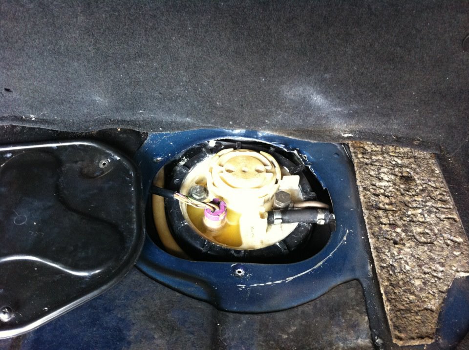

Last time I filled up with petrol, there was a petrol smell that I put down to overfilling then the weather warming up.
However I filled up again today, and stopped at the first click, went out to the car 9 hours later and the petrol smell is there again. Looked under the car and nothing, so I opened the boot and the smell was very strong indeed. I did some digging on google and this went on to removing the boot carpet, and the cover over the fuel sender unit. After removal the cause of the smell is apparent, a small puddle of petrol in a recess on the sender unit.
I have soaked up what was there, so its all gone for now, but it will return.
The cause is I hope a simple seal on top of the unit, which because the car is full has petrol sloshing around underneath. I cannot do anything with it yet, and will need to wait until I have driven the car a bit so the fuel level drops. I'll get a replacement seal from Audi, looks like its around £10 and change it.
Seal on tank sender unit now replaced using brand new repair kit from Audi, I'll find out at the next fill up if that was a successful repair. I have for now left the metal cover unscrewed, so I can quickly see what is going on and if it leaks again soak up the excess petrol again. I hope that I dont have to do that though, and think it should be fixed.
