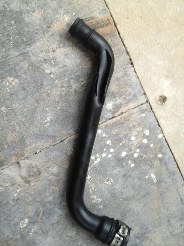

Picture of the old piece is attached - the shredded bit is the manifold end.
That pipe is notorious for splitting. You'll need to get a new dipstick tube as it's part of the PCV system, & will cause rough idle.
cheers - ordered one off eBay - £3.20
