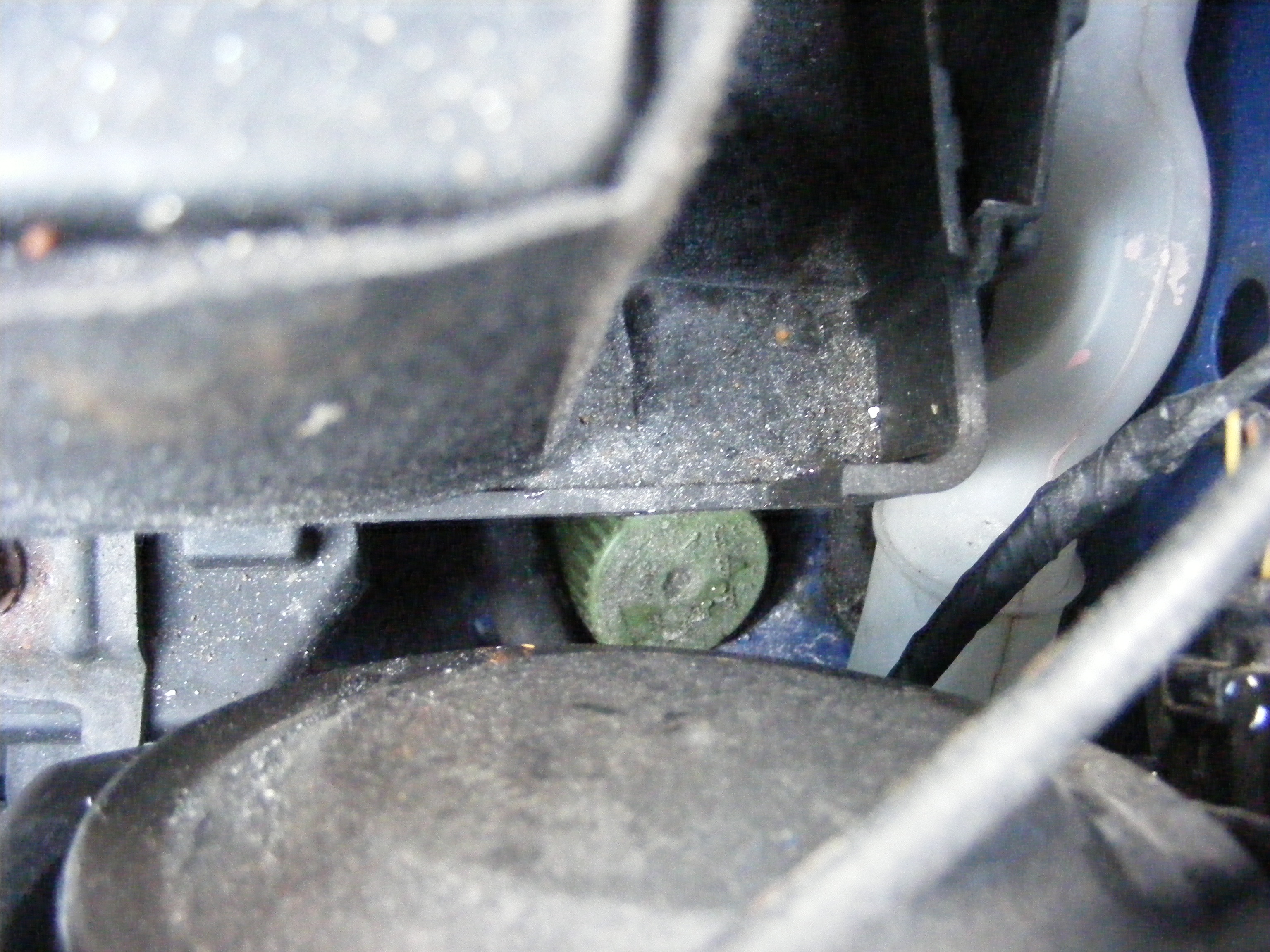

Anyways, I was feeling round the washer fluid pipe as it went down, under the battery area, and I found this green screw on cap which seems to be just sitting there, and an open hole.
What even is this? Is it something to do with the washer/my problem?

Looks like the power steering fluid cap?
That is the PAS fluid cap, is it a Fabia II (your in the Fabia II section) if so where abouts was the water coming out?

Yes, it is a FabiaII
The water was coming out of this front right hand corner of the engine bay, straight onto the floor.
Damon
It will be coming out of the pump then, probably find in the recent cold weather the valve on the bottom of it has split, but the pipe may have popped off. To get to it you need to unscrew the n/s/f wheel arch liner, it's just behind that.

You may need a pump but won't be able to tell until you have a look.
I'd pop the cap back on and check the level.
