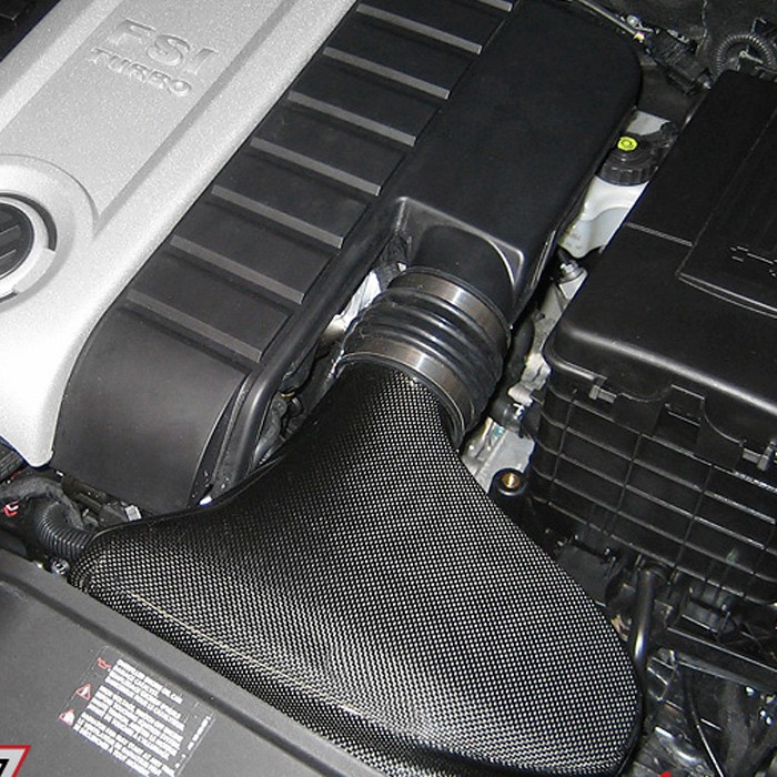

While I know what you are getting at VRSy, I feel I should let you know you are infact mistaken in this case, what you are saying applies to the Carbonio system for the old TFSI engines (which is widely known to be poop!), the Carbonio system for the newer TSI engines is very different and has proven gains in the U.S. where they have been tuning the TSI engines for longer than us, I have one fitted and trust me it makes a very noticable difference, obviously my car is mapped so the difference is more apparent, but my VRS made 260hp and 305lbft at stage 1 with the Carbono intake fitted (local RR day, various cars making correct stock figures so should be fairly accurate) despite the Shark map only being quoted at around 250HP, and my experience was that the intake added what felt like another 10HP (bum dyno)
just something a lot of you guys should know!
Note the very different design, a proper heatshielded intake, with the OEM air feed used, much improved design from the old one!

Hey chaps - am considering an APR Carbino intake too - after reading the above thread I'm still not sure which is rubbish and which is decent... is it either of these two?:
http://www.awesomegti.com/car/skoda/octavia2/carbonio-intake-system-skoda-octavia-mk2-1-8tsi-and-2-0tsi
http://www.awesomegti.com/car/skoda/octavia2/carbonio-intake-system-skoda-octavia-mk2-vrs-2-0t-fsi - this looks like the right one for my 2006 Octy as it looks the same as this one:
http://www.mtk-tuning.com/media/produits/racing/pipercross/img/apr-carbonio-pipercross-tfsi-detail_700x700.jpg
