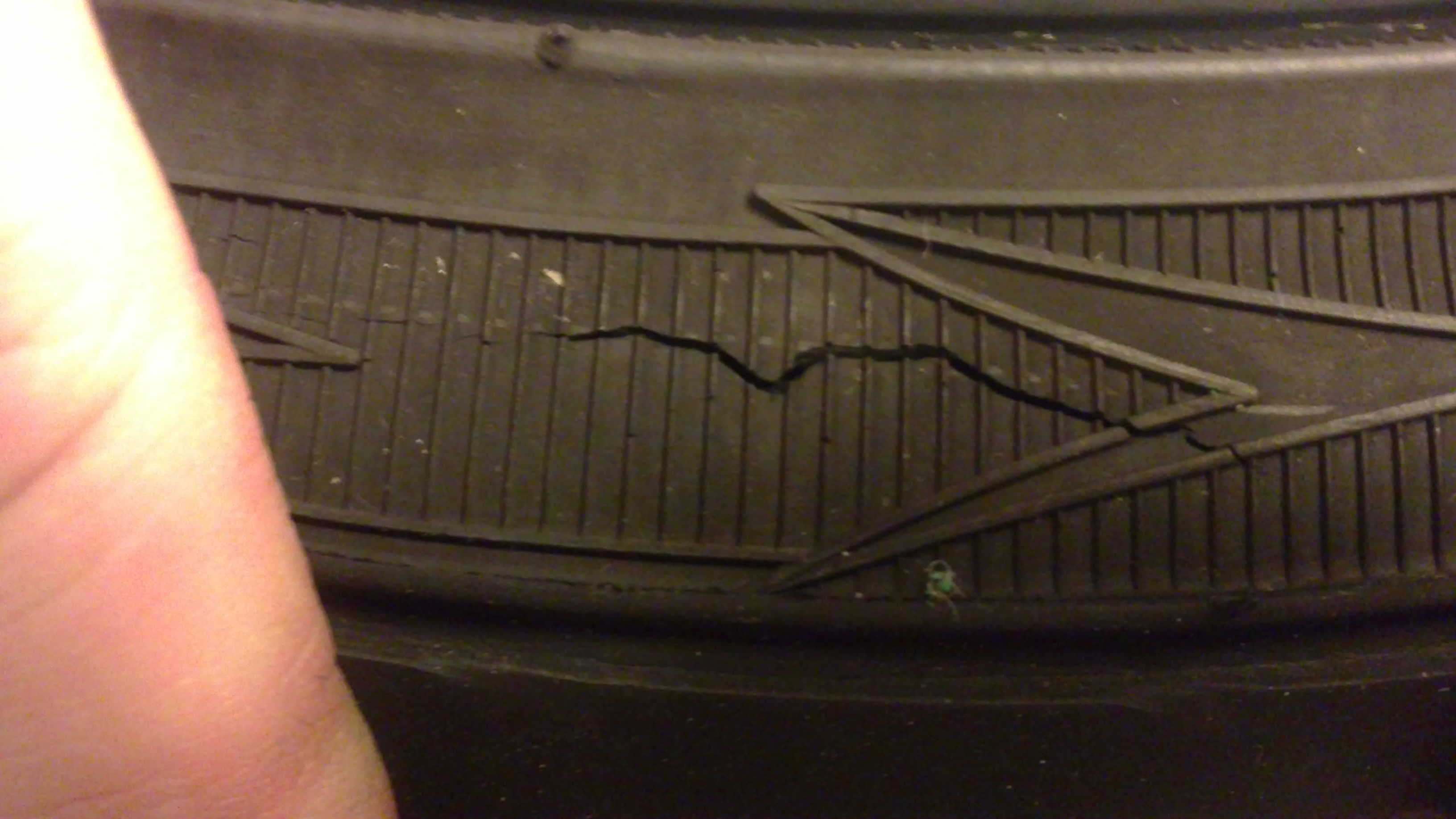

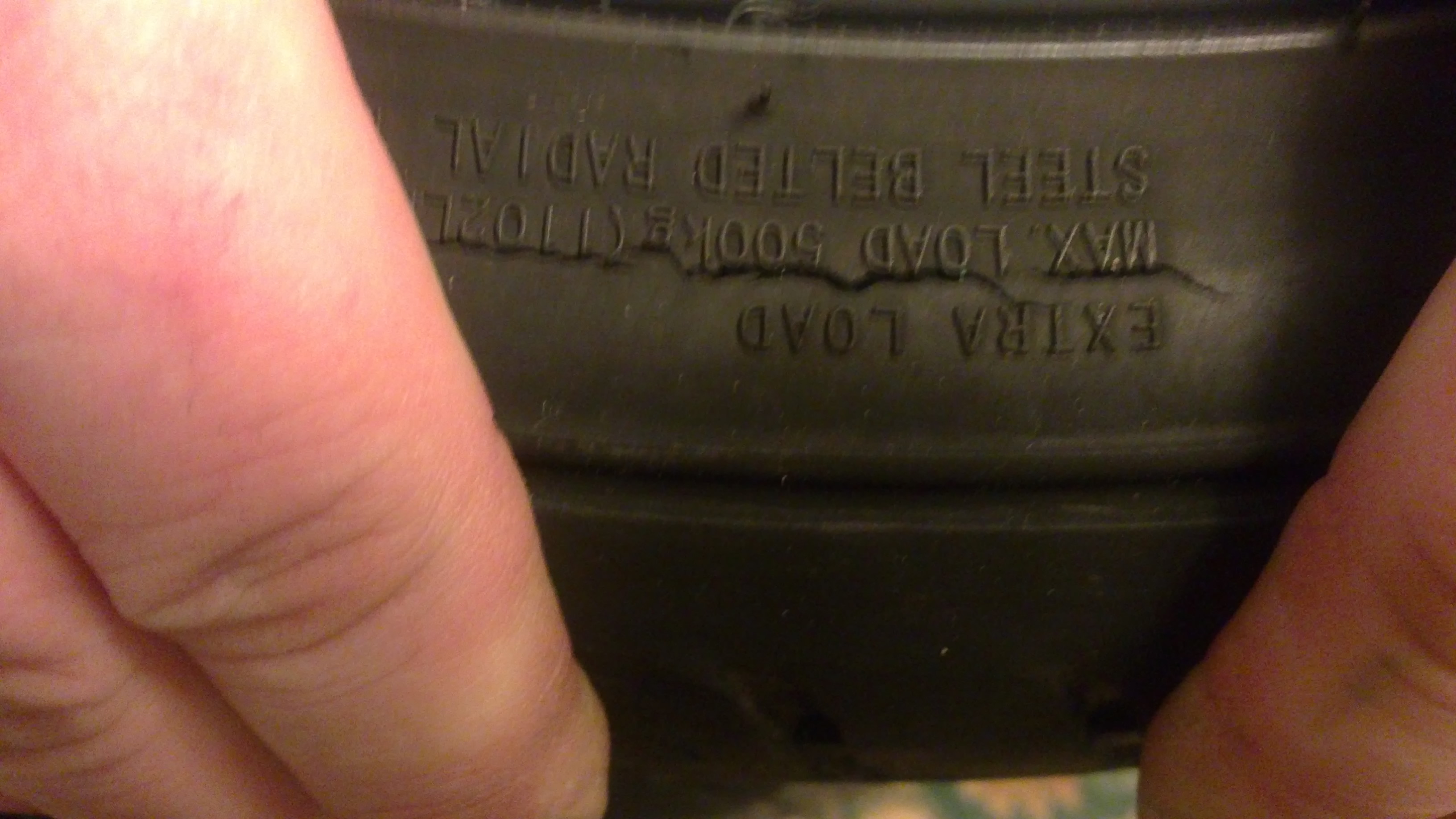

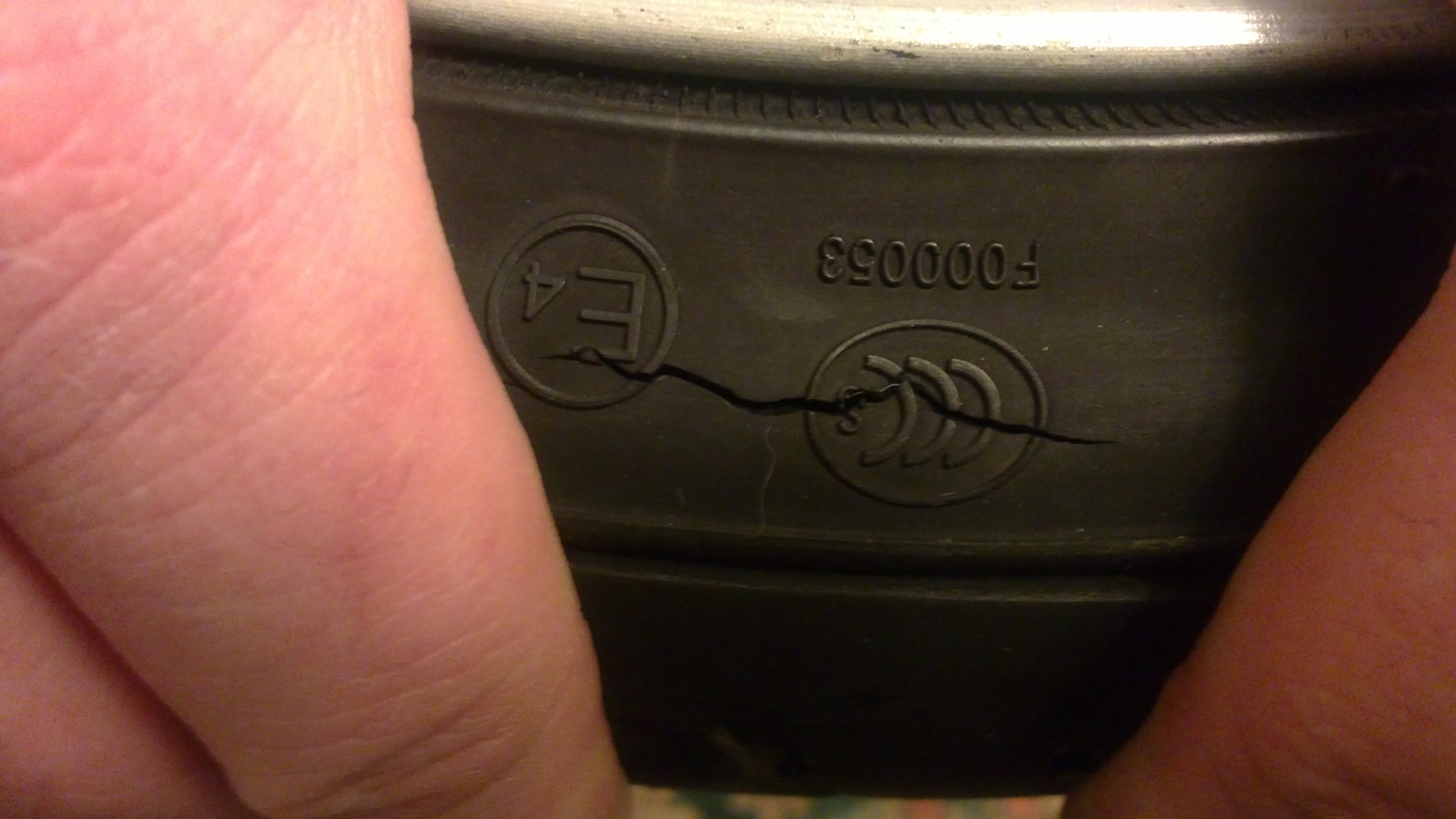

post-58348-0-81458700-1329171910_thumb.jpghi all ,iv'e just taken off my 215/35/18 wheels for winter ,
when i went to clean the inside of the wheel ,i noticed major tyre damage (due to running such low profile tyres)
has anybody else had this ???????? :'( :'(
here are a few pics !!!

hi ,just a quick update it's damaged three tyres ,,all of which have splits on the inner tyre wall ,i'll look what make they r tomoz and try to put a pic up :doh:

From my tyre fitting experence the cheap low profile tyres would split on the sides after time if not correctly pressured or just real cheap nasty tyres, Just like they had been slashed

there are a few speed humps near me ,but i think it's more likely that pot holes have done the damage !!! :S

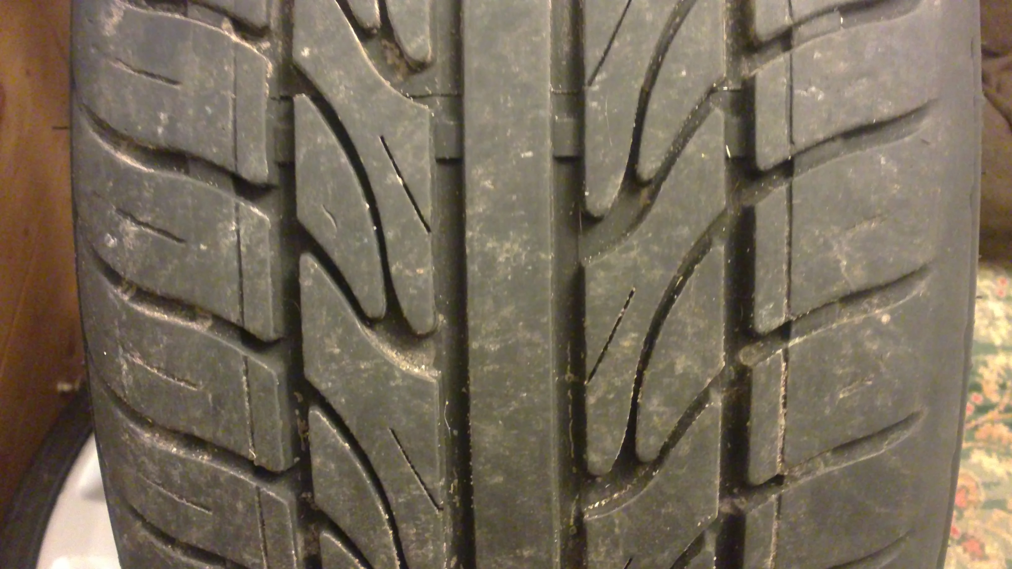

One of my fronts was the same as them. Noticed it not long after i bought the car while checking it over. StandaRd size thou on cheap tyres. But tyre depth was like new.

30 psi, so low then. vRS standard pressures are 34 front 33 rear, and I'd be tempted to run a bit more of 35 profile tyres.

Imo its the cheap tyres used to find this alot with fulruns always inner edge too
