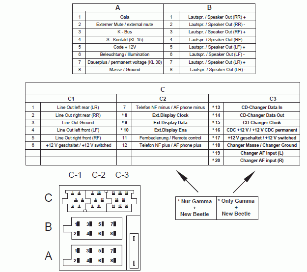

Diagram of original radio in small picture,
large picture shows pinout of VW headunit, but the main ISO connections are the same.

Cool. Cheers matey. Just out of interest Pine number A5 says code +12V could I fit it up to that one? As there is nothing in that side of the ISO lead?
