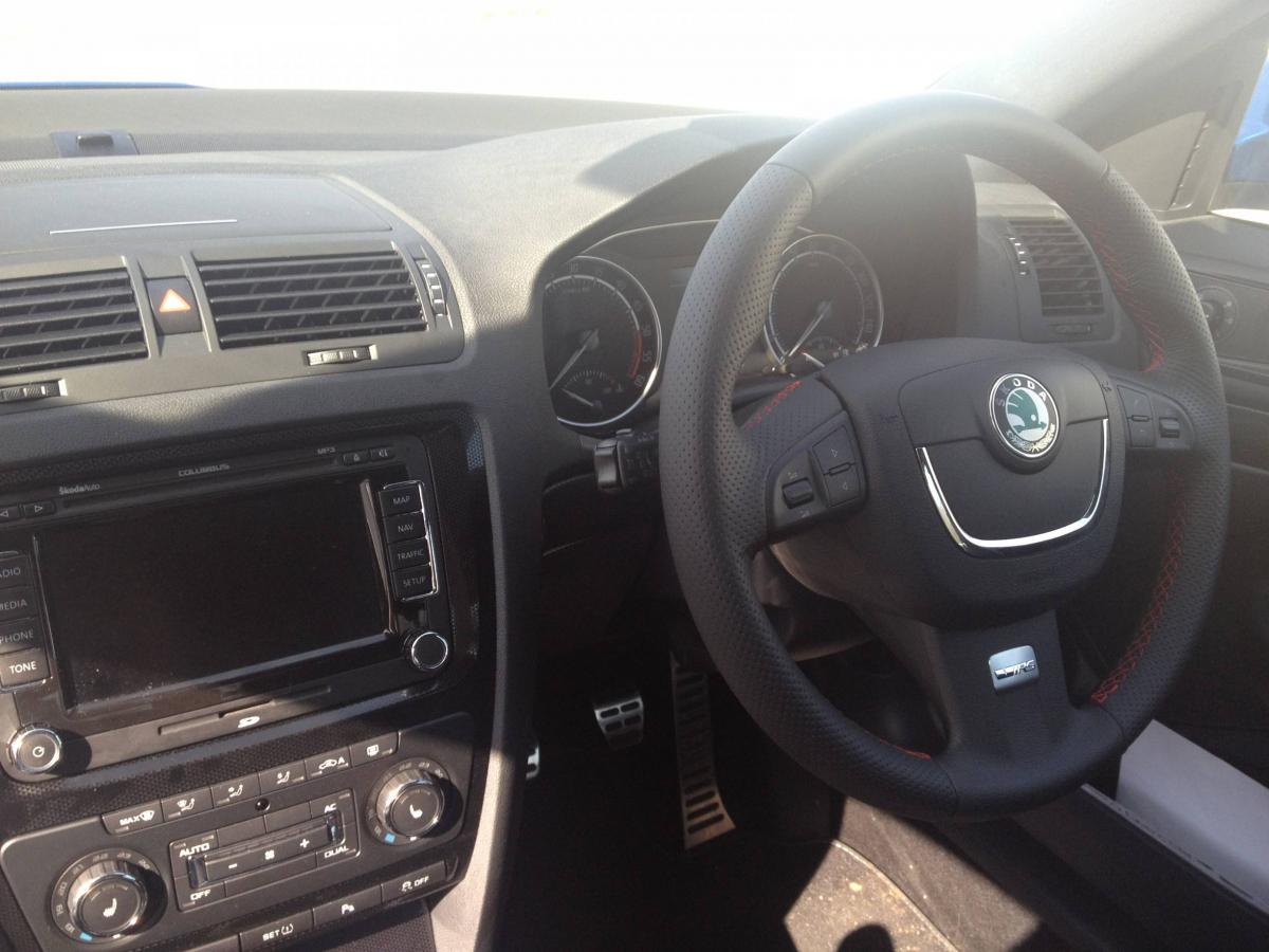

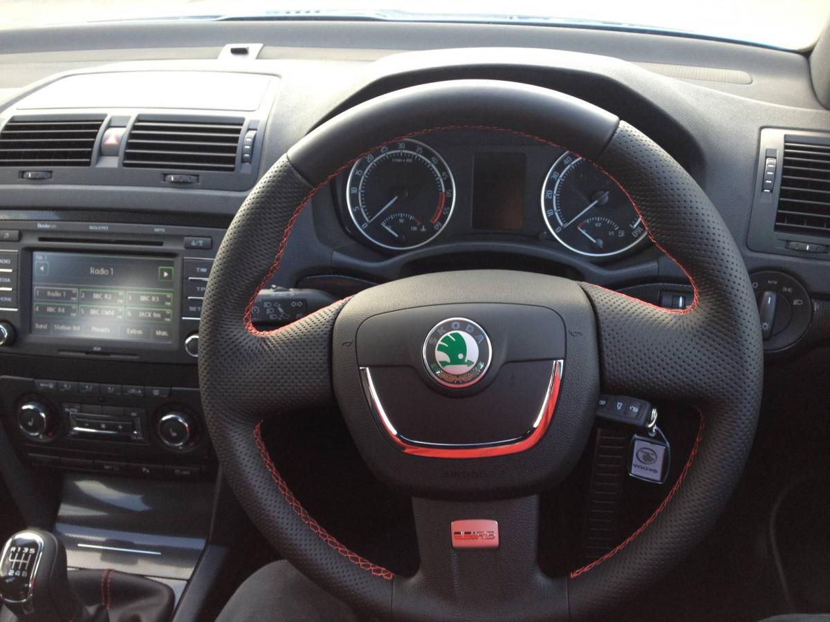

Columbus and MFSW fitted.
Finally got the Columbus and MFSW finished over the last week. Why Skoda wont sell you a manual car with MFSW I've no idea.

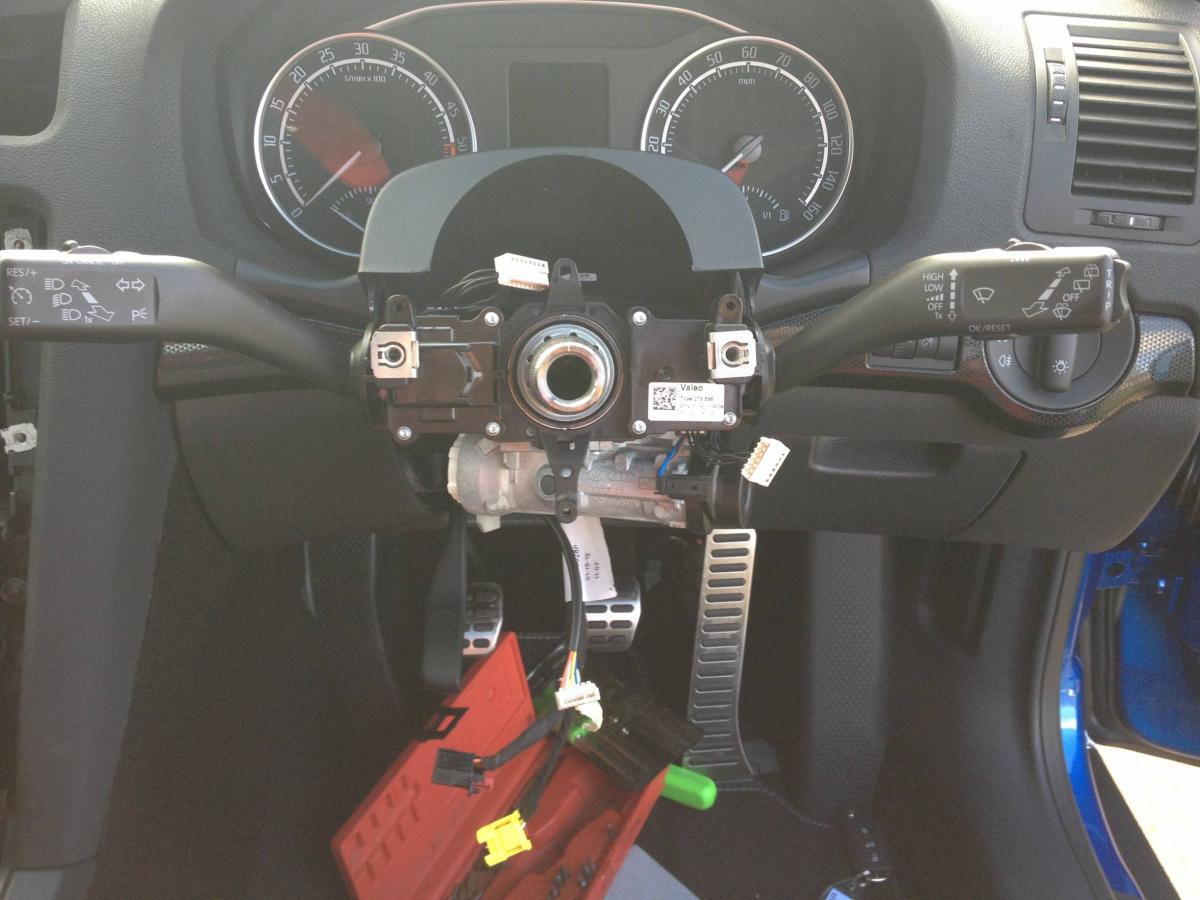

I didnt write out a full "how-to" as it's all been done before and is nothing new. The links above give lots of pictures and details of removing wheels.airbags etc.
Got the steering wheel here..
http://www.skodateil...5%29%20facelift
Coded in with VCDS, Updated firmware and V8 maps and some custom POI's using POI Inspector http://poinspect0r.blogspot.co.uk/
Changed a few other bits with VCDS, CH lights via fogs, Country code to Australia to get rid of the km/h speed as per http://www.briskoda....d-from-maxidot/ and turned off the annoying seat belt warning.

Same as I've asked a couple of others in the last few days, how did you find the Columbus install?
Simple. Its only held in with 4 screws. If I can do it then anyone can.
Thanks for posting - didn't realise skodateile did the non-dsg MF wheel with the red stitching too. Nice.
Top job Keith making me want that wheel now...... my Columbus went in yesterday :rock:
Looks good!
