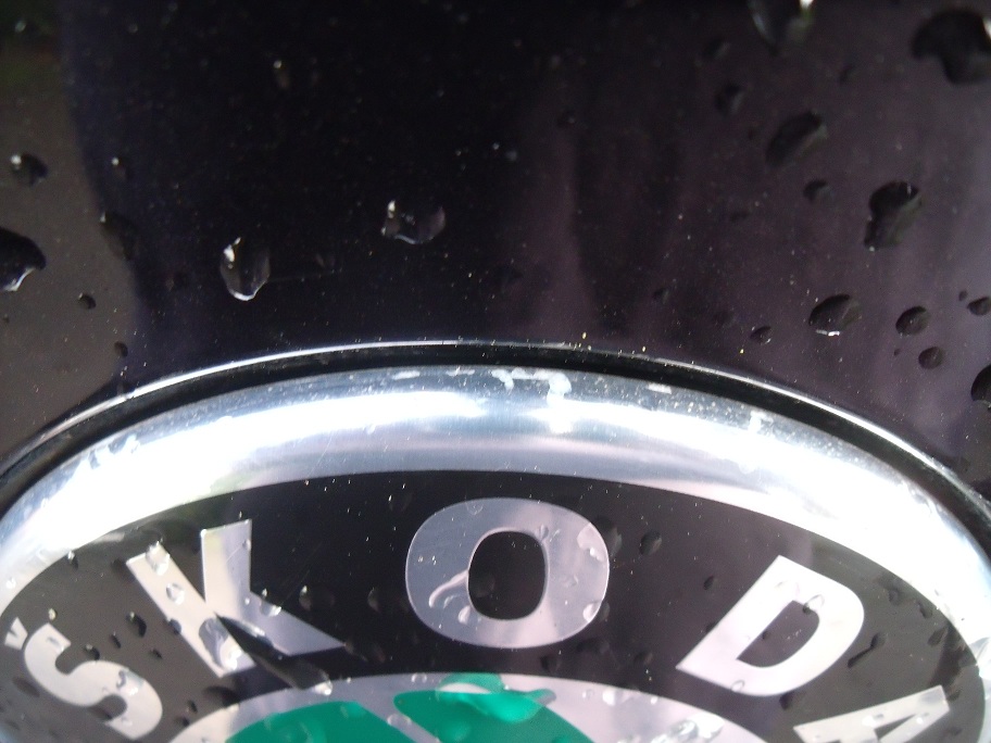

does anybody have a pic of the recalled badge?
just wondering what all the fuss is about

I already had the rear badge changed on mine and noticed that the new badge is showing signs of white round the edge. Not urgent I guess. Is it caused by water getting into the badge?

Also, I am sure it is white worm that I have, But can't seem to see any pic's of it anywhere. Can anyone put a pic in this thread?

It takes minutes, and basically from the edge of the badge inwards has white "squiggles" in it, where water has got in.
picture is from my old yeti , looks like the new one is starting to go as well
Your newer Yeti is an 11 reg so only six months old I wonder if it could be down to the chemicals the car is cleaned with?
Its a year old next month (getting near time for a new one :giggle: ) and I use autoglym shampoo which should not affect it. There was a thread way back about pressure washing and hand washing but from the comments it looks like it is just water getting in the top layer of the badge.
Yep, that's just exactly what I have on my front badge and mine has only just passed 7 months since I picked it up... :doh:
