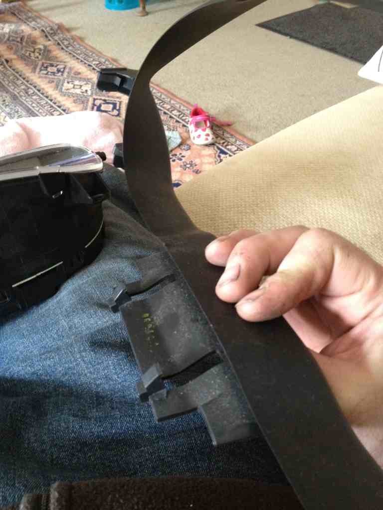

Yup just did mine it felt like you were breaking it - here's a pic of the bottom clips looks like you have to press down or summat :-)
