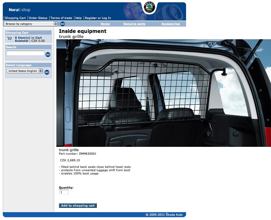

I'm after a cargo barrier and have found this genuine part, which is as close as I can find to a proper full barrier (I'd prefer a full barrier but can see that it would chew up some scarce real estate).
https://eshop.skoda-auto.cz/webapp/wcs/stores/servlet/ProductDisplay?catalogId=10101&storeId=10001&productId=1100000000245489&langId=-1&parent_category_rn=70000000202
Does anyone know if the nuts (mounting points?) for this thing are pre-fitted (as they are with subaru foresters) - or if they have to be factory specified? Ideally there will be two sets of mounting points, one behind the rear seats as per the product photo and one behind the front seats (like the forester), but I'm guessing that might be too much to ask for.

Just got one of these yesterday, haven't fitted yet, but checked the parts that came with it, the mounting points have to be drilled out of the headlining and the rear 1/4 panels, I don't know yet if the body work is pre drilled but to secure the guard at the 4 points are are what can only be described as metal rawl plugs,( the ones used for plaster board) whereby you place them in the hole and when tightened up they secure themselves to the bodywork. I hope this helps, looks like a pain to do but once it's done, it will be good.

[...]to secure the guard at the 4 points are are what can only be described as metal rawl plugs,( the ones used for plaster board) whereby you place them in the hole and when tightened up they secure themselves to the bodywork.
Do you mean bolt-tightened rivet nuts? or something similar...
If drilling in metal, a proper rivet nut is a nice solution. I have a Beta one. This thread mentions a Wurth one http://vagdrivers.net/forums/index.php?showtopic=59753 and there are cheap chinese ones about too (ge Lobster).
I take it your talking about something similar to a hollow wall anchor used on plasterboard stud walls, that expands out behind the board as you tighten up the screw :wonder:
Would explain why some members are trying to find a new fixing kit when transferring the guard from one car to another, as these obviously cannot be removed once expanded out.
TP
I think these are the actual things that Skoda supply for fitting not only the dog guard, but some other bits as well:
If you Google "rivnuts" there are plenty of suppliers. You just need the correct size.
There actually more like the ones that " the plumber" has in post 14. Will take a picture later and post it, cheers
