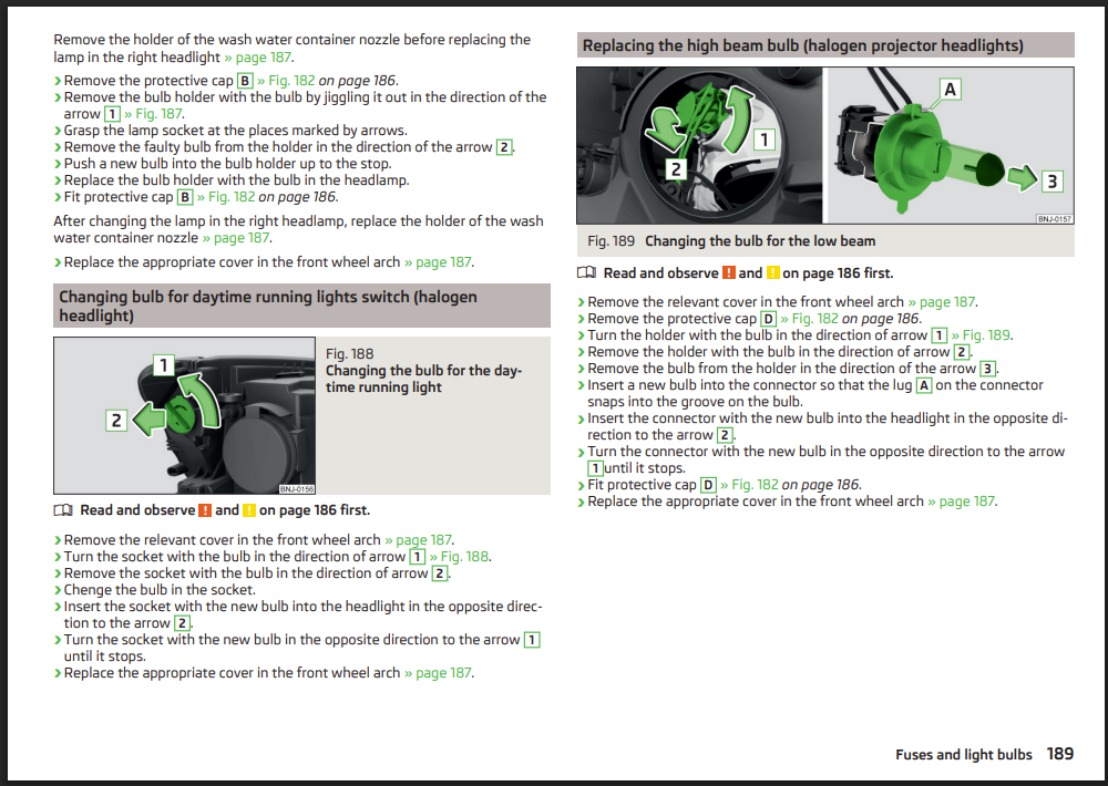

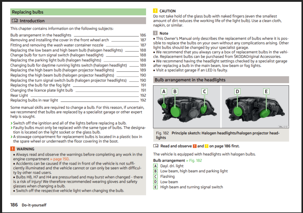

Can anyone please point me in the right place to find out how to change the daytime running lights situated in the headlight housing on my 2016 Fabia estate? I rarely use Briskoda because the search facility for information never returns and content for what I am looking for. So I am asking if anyone can help me. I've searched video hosting sites, and I have found little information pertaining to the 501 Bulbs W5W type. Pleas help. Thanks.
