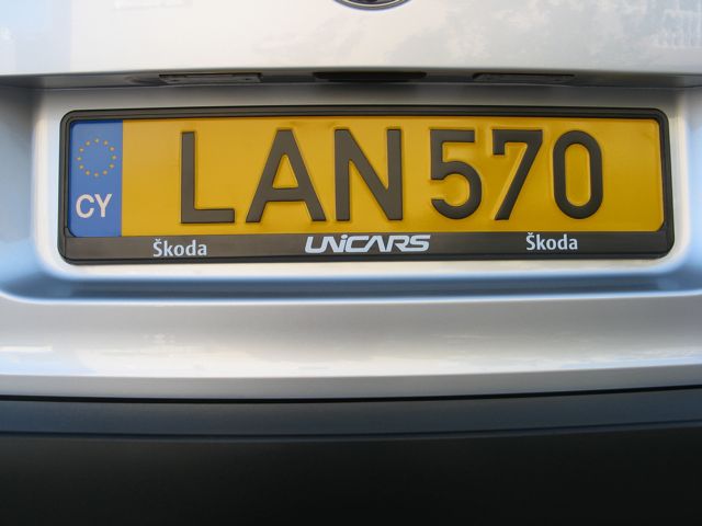

Hello
I'm putting a cherished plate onto the Yeti but cant see how to remove the rear reg plate surround.
I unscrewed the one screw I could find on the inside panel but this didn't seem to help in anyway!
I'm sure its really easy but its not slapping me between the eyes just yet......
Many thanks
John
What number plate surround?
Most rear plates are either held on with tape or self tappers.
Hi, if your reg plate surround is the same as mine the bottom part, where it says Unicars, unclips and the plate slides out.
Nice and easy for number plate theft!
So two screws or double sided tape is theft proof!
No but its like a burglar alarm, they go and find an easier and quicker target
Not sure how easy it is to get number plates in Cyprus but it has been made more difficult over here, so rather than pop into Halfords for a false set plates it is easier to steal a set.

Thanks for the input so far..... the problem is that it seems to be very well attached and if I pull too hard, the plastic surround will probably break. If anyone has removed theirs, Id be grateful for the definitive answer.
Cheers
I still don't understand what you have. Can you post a photo?
If you have the German type "carrier bracket" that's also used by many VAG dealers in the UK - similar to Bohuslav's but without the removable bit at the bottom - I think you may find that the number plate is held in the carrier bracket with double sided adhesive foam pads, and the carrier plate itself is secured to the tailgate with two screws that go into bungs in the panel. There are no screws inside the car that you can remove to help you.
When my rear number plate decided to detach itself at one end from the carrier bracket, the highly experienced technician at my dealer just gave the whole assembly a good tug & it all came off the car leaving the screws in place. He then proceeded to place the assembly face down on his work bench and break the carrier off the number plate, scraped off the remains of the sticky pads, remounted a new carrier on the car (he said they only cost a few pence) using the original screws & then stuck the number plate back on using new sticky pads. Highly technical - I don't think! It took him all of 5 minutes.
So you might be best nipping down to your dealer & asking for a new carrier bracket & then just break off the old one as above (unless it is the detachable type mentioned by Bohuslav.)
Most of these have "key " to unlock them you place it in three areas to push down the clips, then it swings up
