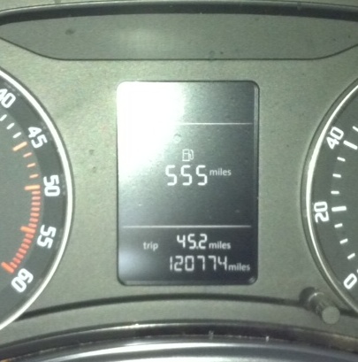

Ive heard the term, this is my instrument pack....is it maxidot?
If it is, would there be a secret menu to access?
Cheers
Ignore that Ive just checked and its not a maxidot! :(

Off topic but 120k in 3 years.....wow your car has been busy! :-)
yes Mikey well spotted, I bought it at the weekend - 1 company owner full dealer history! drives fantastic without any squeeks or rattles!
