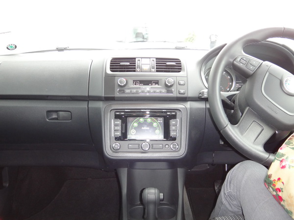

I think it is due to sensors placement by the side of climatronic's control unit. The temperature that is indicated at the Climatronic is the ambient temperature and the preferable temperature, but there is no way to know the cabin's temperature, so it is possible the cabin's temperature to be greater than ambient, remember the sensors reads the internal temperature, thus the unit blows cold air.
Plain A/C unit. There are no sensors at all
Climatic (Semi - automatic). You can see the sensors (actually one at the right) by the a/c and recirculation button and the word climatic under the central knob
Climatronic - Full automatic. You can see the sensors by the buttons sides right below screen.
At the pre F/L cars there are the same vatriations but the knobs are different.

Except the word 'climatic', the left knob must also have numbers that indicates the preferable temperature. The 'climatic' photo few posts above (#12) is from my car. Plus there are sensors in my car's photo. If all these are missing then it has to be a plain a/c, which of course it will works fine.

That's manual air conditioning, same as on our MY2012 SE.
This is Climatic on our MY2009 Fabia 2.
Climatic has the two sensors either side of the aircon/recycle air switches, climatic under the fan speed switch and a C under the temperature selector with the temerature figures 16, 22, and 28 in degrees centigrade around the temp dial.

The knobs are different, pre facelift have round knobs, post facelift have the straight type knobs.
But if it hasn't got the sensors and temperature settings then it's manual.
Climatic was dropped from the Fabia range for MY12 which is any car built mid 2011 onwards.
