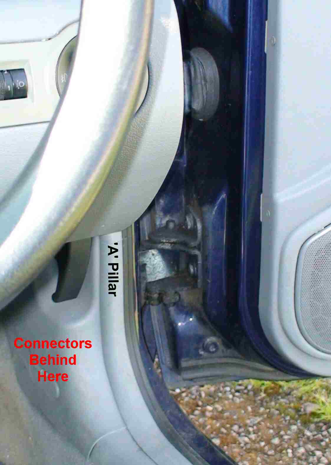

You don't seem to have any power to the door. If you remove the lower 'A' pillar trim on both the left and right sides, you will probably find connectors. Check they are OK.
Another common problem is that the power wire to the door can break where is passes from the 'A' pillar to the door. Trying gently pushing/pulling the wires from the 'A' pillar side.

what do you mean by "A pillar"
There are two power wires - Red/Yellow and Red/Brown. Check the items in post #7.
