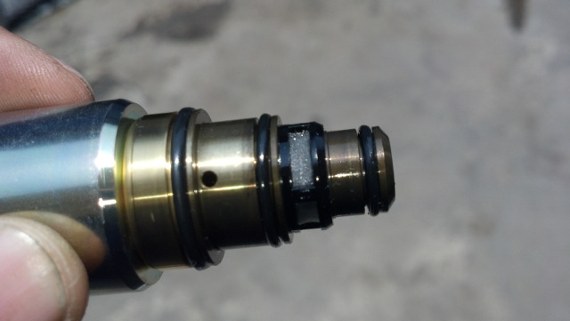

The old valve had some debris. I can only attribute this to the first gas recharge event about a 1.5 years ago when I notices gurgling noises and go the gas recharged. Since then I have had cooling problems that got aggravated in recent months.
Here are a couple of photos of the old valve. Those are metal shavings that you see in the pics. The aircon mechanic was not too concerned about those and I don't know if I should be worried about it. I probably has been in the system for a while now.
The compressor load and pressure readings are almost the same as a brand new aircon (1 month old).
After replacing the valve the evaporator temperature goes all the way down to 5C!
