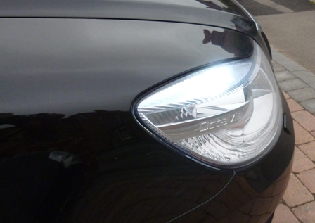

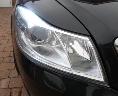

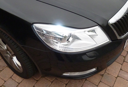

Well, just received the 5 SMD version of the LED bulbs, and so far so good. No errors on either of the Octavias, and the lights are so white they match the HID's perfectly
Wil try to get some photos up
Mike
EDIT Photos added
I hope this is it :drunk:
Mike
EDIT Photos added
That DOES look pretty swish!
