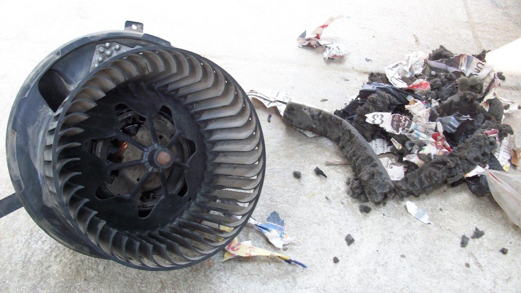

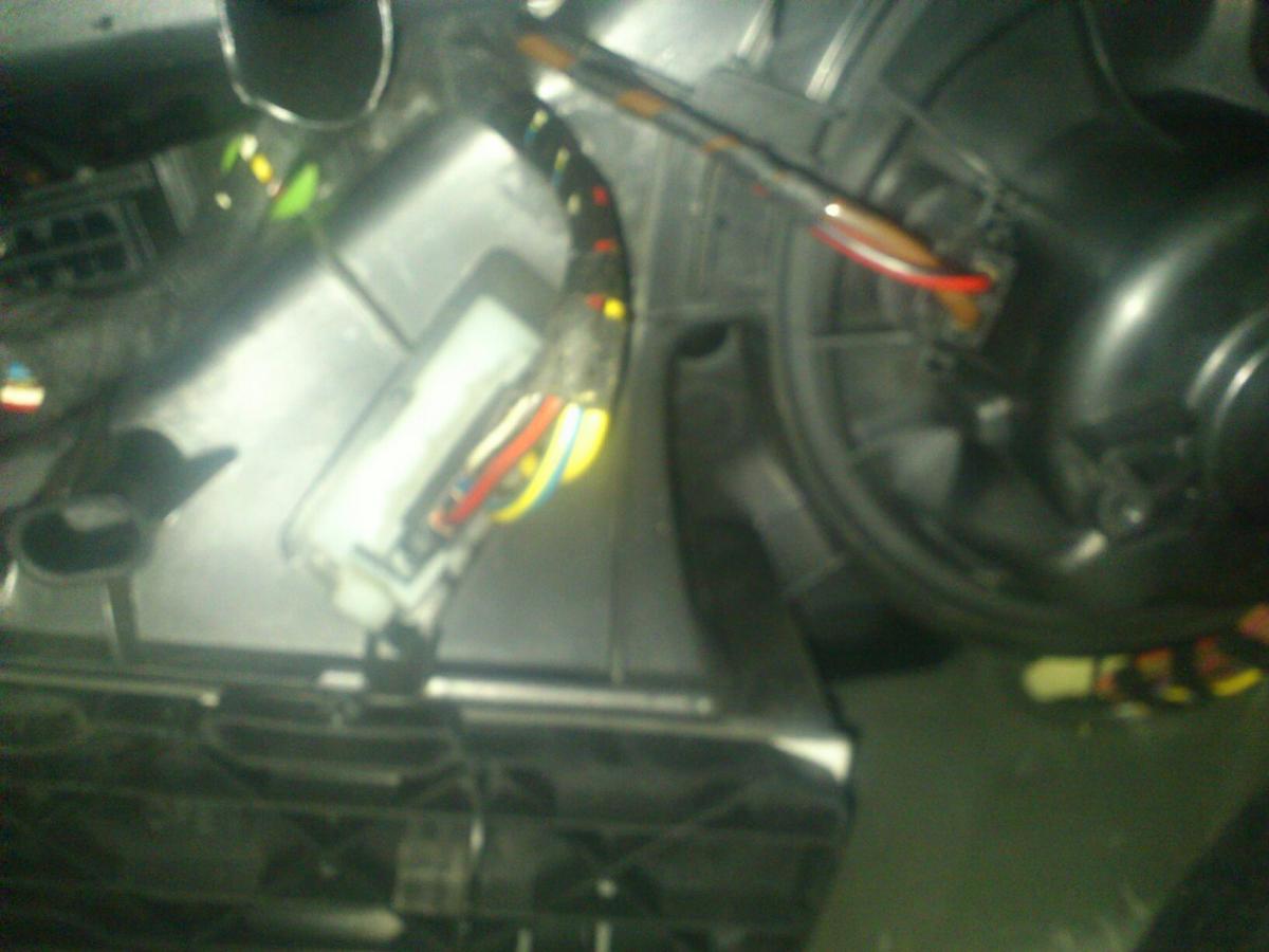

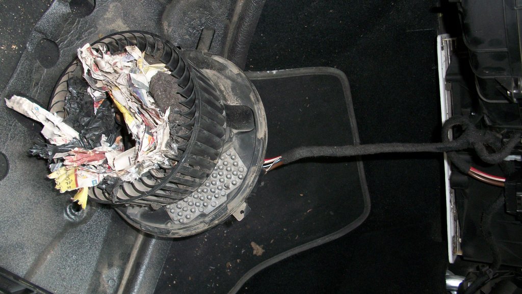

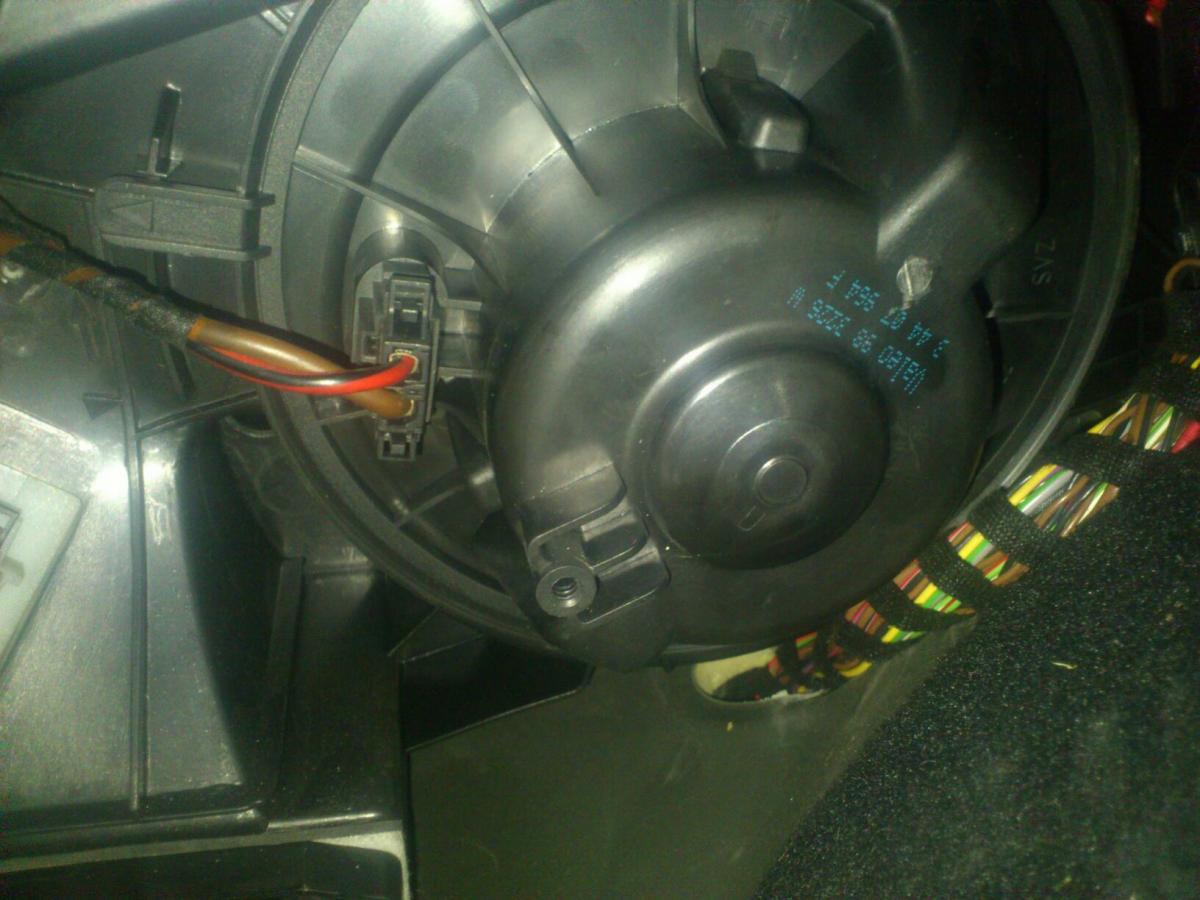

Had this problem yesterday where in the Blower Motor started making a grinding noise when turned on and the whole of the passenger side dashboard was lightly "vibrating". Sounded something like the motor was struggling to turn as something was holding it from doing so. Decided to get the dashboard off to inspect the cause. Everything was going fine when I got stuck trying to get the blower motor off. Then this post came to my rescue, as you have mentioned in point (3) of your post, was able to get it off by pushing the clips down and turning the motor.
Was shocked to see so much stuff stuck in the blades, thanks to rodents who have done this. The following pictures should give an idea on what was exactly happening here over time:
That's an incredible volume of debris in the fan! How will you prevent it happening again?
Wow, that's insane! :o
Regular clean-up I guess now that I know what's exactly happening and what to expect!
I wonder if this is a part of the check-list for a yearly scheduled service though, shouldn't it be?
Have rodents destroyed your car's dust and pollen filter - which is due replacement every 60,000km or after 2 years, whichever comes first - since that should have stopped those bits getting into the blower fan?
No, I checked the filter while the motor was off and it was perfectly alright. As a matter of fact, the filter is changed every 1 year when the car goes in for its scheduled service.
I guess air that is sucked in first goes through this motor and then to the filter, that's why the filter is clean as most of the bits were stopped right here at the motor itself.
I live and learn. I would have hope that the filter protected the motor. However, having read other posts about leaves etc getting into the fan, I should have realised I was wrong. What have the rodents chewed in the engine compartment, or have they introduced the debris from elsewhere?
Part of it and majorly is debris from outside sucked inside, while the rest seems to be some kind of cushion behind the dash, probably to seal some thing, but not sure though.

My question is:  it is possible to directly remove the blower motor (as instructed in point 3) without Opening the glovebox (point1) and Gaining access (point 2).
I opened the 2 thumbscrews and removed the cover, so I opened / cleaned the pollen filter and I can see the fan as shown on the pics.
If it is possible please explain how to remove the fan cover in order to clean it.
