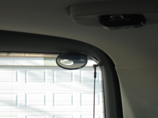

The reason I want to unscrew them is for mounting 2 tilted small panoramic mirrors as reversing sight aid. I don't want damaging the reffined trim of the Yeti with self drilling screws. Unfortunately, there are no 3rd brake light screws here, as in my precedent car, where I managed to mount a big panoramic mirror using one of the screws, wich worked brilliant for me !

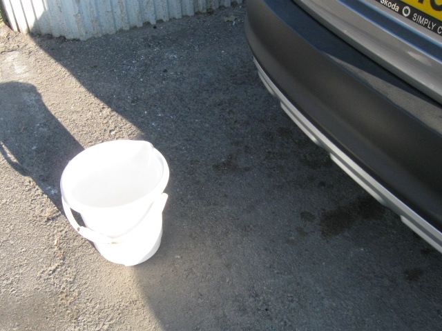

Neither double sided stick foam could resist the heat and the small mirror I have tryied in the Yeti did'nt stay there for long. IMO 2 mirrors are better than a central one, as you can apreciate distance from your car's corners to cars or objects not parallel to your car. As long as I could try it in the Yeti:
An object "touching" the rear wiper spray nozle image - was in fact 50 cm away from the rear bumper.

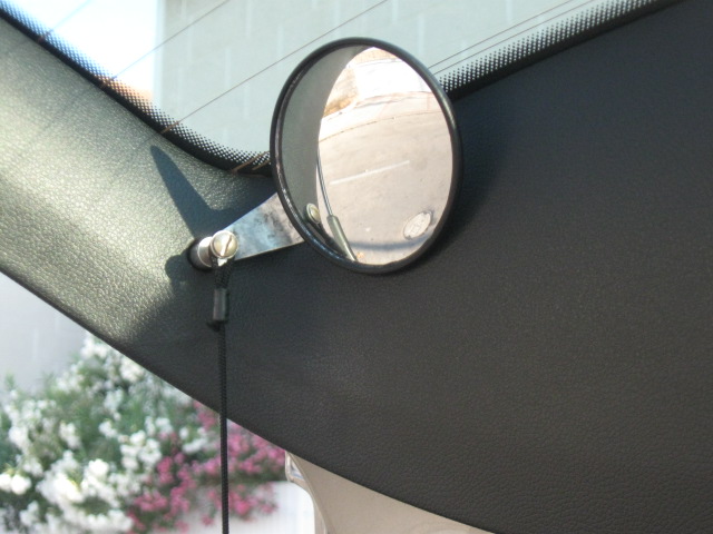

As promised: First stage of project - testing with small round mirror
Edited by rafi_arch
Thanks ! I paid 5 euro and downloaded Bodywork manuals and Electric diagrams. It gave me the confidence to safely unscrew the "peg / screw". Indeed, it's a T20 torx (female) plastic peg 2 cm long + a metal M5 (5 mm metric thread) 1 cm long screw protruding from the plastic peg.
Looking at my car, it looks like the screw goes from the inside of the plastic panel and the peg contains a female threaded metal bush. Because the recess is very deep, looks to need a long screw + cylindrical spacer + lateral support in the recess. Looking good so far!

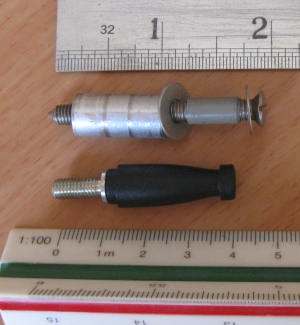

Homemade "hinge / mirror holder" vs original hinge...
Screw = "key cylinder" mounting screw
First washer = to hold the cable
Small spacer = alu, female 5M threaded - don't remember from where they came...
2nd washer = to hold metal sheet mirror arm against big spacer
Big spacer = cuted from an alu tube, remains from a precedent work
All stuff from my "misc" box, the box wich my small boy is delighted each time I open...
Enjoy !
