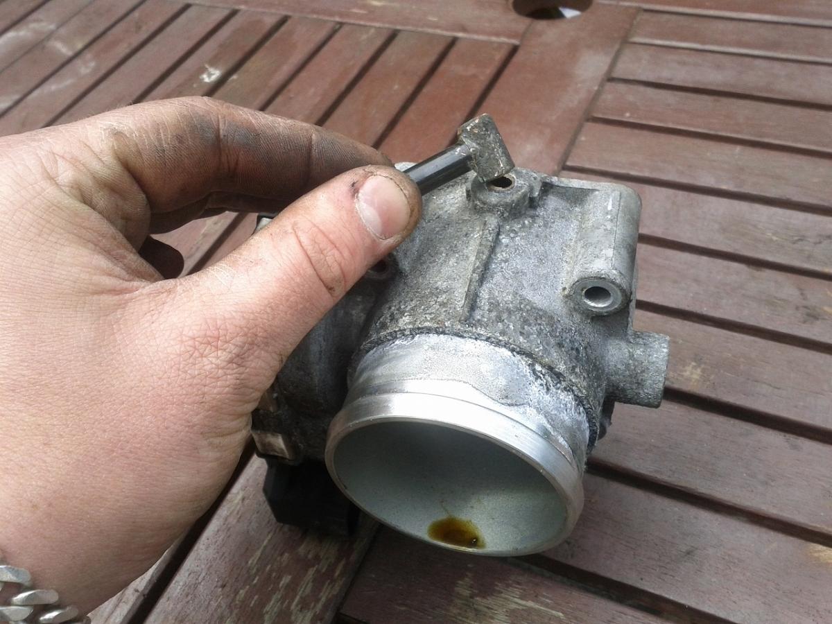

What have i broken?
I was a little heavy handed earlier and was wondering if you guys could help me out and tell me the part that i have broken and if i can buy it. :sweat:
cheers kriss
Oh dear !!! Part of the throttle body !!!!! What was you using a hammer lol
haha just some grips to pull the pipe off and it snapped :think: can i buy that part?
A new throttle body is about £300 :(
There are plenty of mk 1's being broken for spares at the mo, you may get lucky.
Nope - it's integrated into the TB.
If you're struggling for cash, you could just grind out an appropriate hole and put yourself a brass pipe fitting in...
Else I suspect it is a replacement TB.
Pm sent
thanks alot guys, think ill try and bodge it for now n see how it goes.
If you want to try and repair it, then tap the hole and use a right angle air fitting such as
+1 for drill and tapping a new thread then fitting a brass nipple. Any decent engineering shop will be able to do it for a few quid. Failing that just do it yourself, will probably work out more expensive i suppose. Taps are quite pricey these days, tap wrench, cutting fluid, drill bits etc..
Good luck!
Or blank it off its not needed anyway ;-)
sounds good to me pal :)
